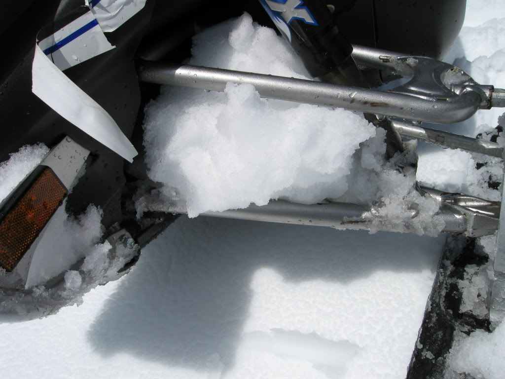

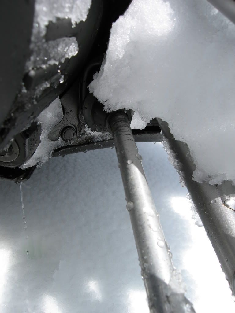

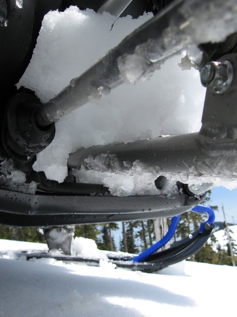

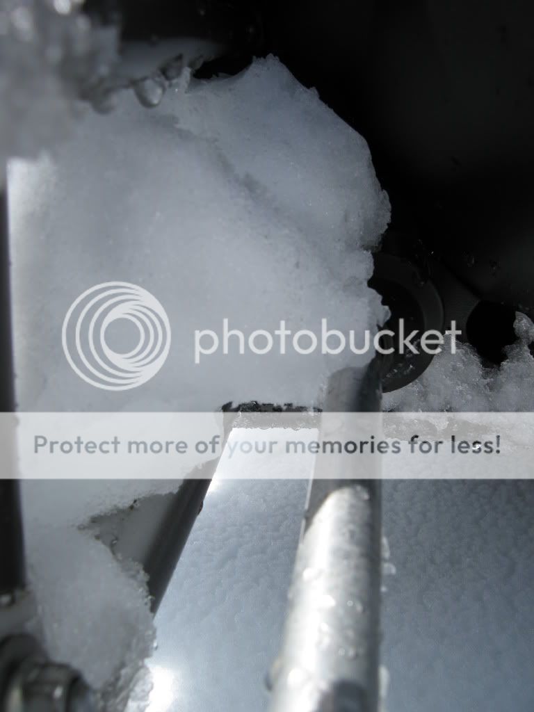

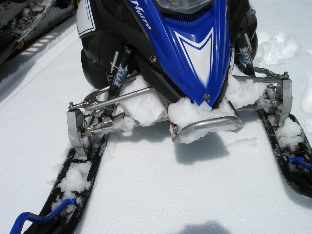

pictures of the front end with snow packed in it. Note that I have to kick it to get it removed, and once removed it will pack in really quickly and I will have to repeat the process. Fun stuff.
