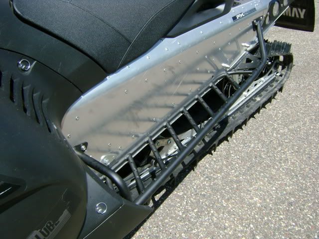

I was re-arranging at the shop today and took some pics of my boards.
Granted, there is not any snow on the ground here in Minnesota, but snow doesn't stand a chance with the Airframe Boards:
My .02
My .02
hugger70mtnmax
So after the last few months of hard riding I would assume you could say that these are holding up very well.
Guess you must have had Skinz install them for you

hugger70mtnmax said:So after the last few months of hard riding I would assume you could say that these are holding up very well.
Guess you must have had Skinz install them for you![]()
Everyone and their brother had a chance to beat the heck out of my sled this spring and the boards held up just fine.
BTW, I installed them myself
The traction screws do not come installed, but are quick to put in and then the pattern of screws can be customized based on riding style.
