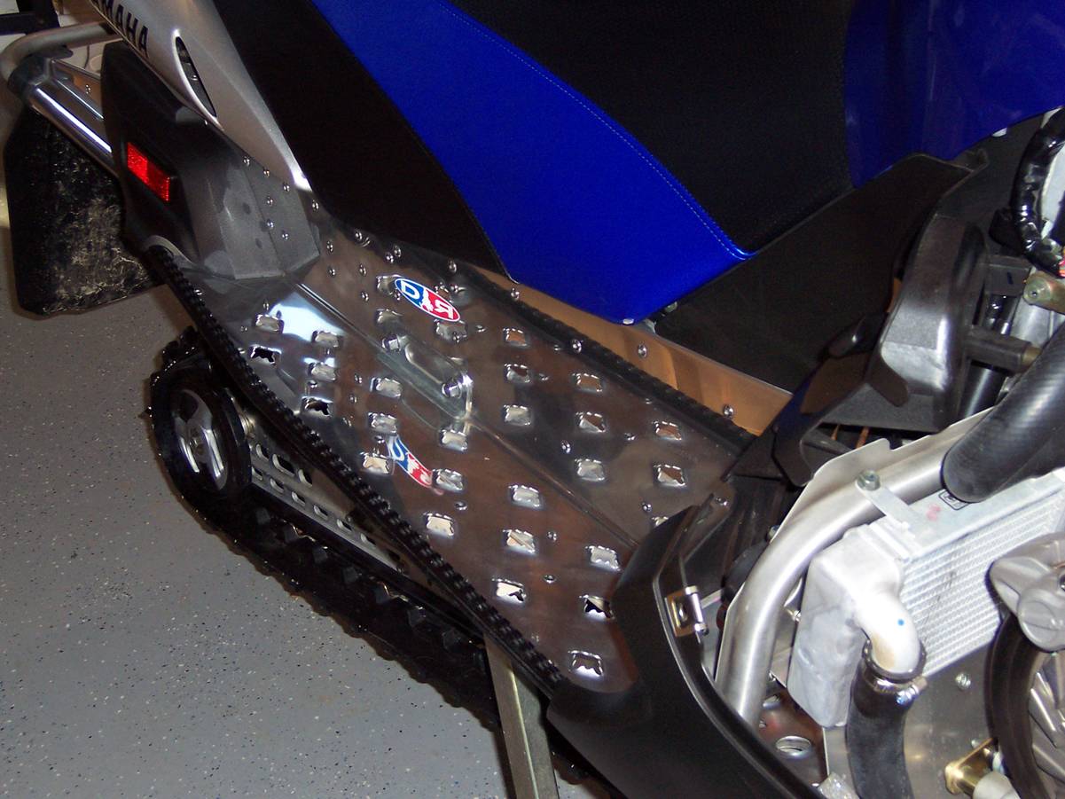

I tried something new for polishing your tunnel that works good I have tried many things and I think this is the best stuff here is there web site http://www.webbikeworld.com/motorcycle- ... polish.htm

xcsp
Polishing the tunnel
How long will it stay looking that nice? Will it go the season w/o touching it?
myyamaha
it will last sometime but it is easy to go over it again to make it look like it was!

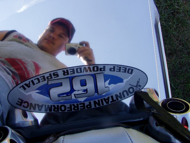

ok this is what I think is the best way to do this I like to use wet sand paper on the tunnel first 1000 grid then 1500! then I use a drill with a 3 inch polishing pad I bought at walmart but U can do it by hand just take longer I put it on with buffer and then take it off with buffer!
