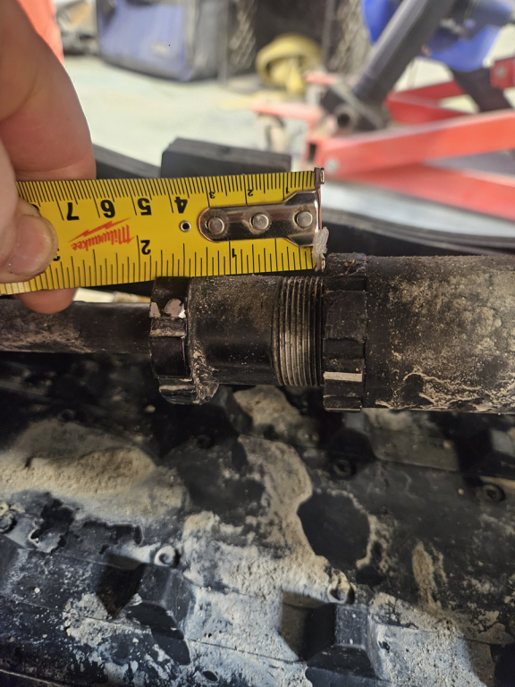

Just to confirm , front springs are set to "0" pre load with the front end suspended, Limiter strap is in the second last hole and the transfer rod gap is about 1.5" ?
