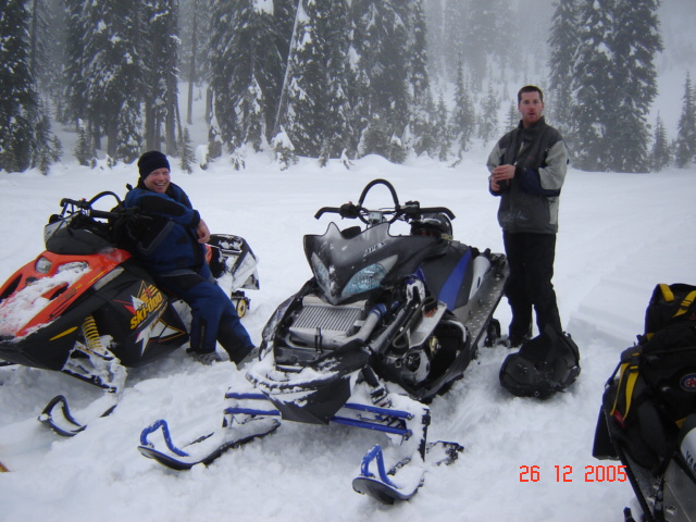

Joker2, what are the issues? Engine, turbo, clutching or chassis. Can't help if we don't know. looks as though as if you have the clutch side plastic off. Clutching? Mike Knapp#17
