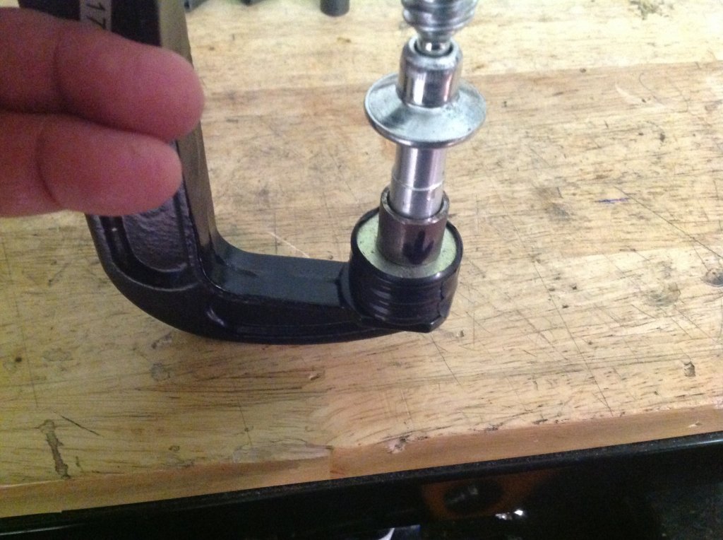

how are those bronze bushings working???Primary roller bushing issue? Never heard about it!
What i used to instal and remove bushing. One way for roller the other for weight
Tuesdayx
Did you make that press set up?Primary roller bushing issue? Never heard about it!

custom
Not enough WOT testing to talk.... but i think they will solve the problemshow are those bronze bushings working???
i have the thunder 14,8 in my clutches for now
The little "push pin"tool i have is made by GForce

How much clearance are you leaving between the pin and bushing?Primary roller bushing issue? Never heard about it!

custom
I don't have a 1000$$ tool to be extremely preciseHow much clearance are you leaving between the pin and bushing?
Normaly they are all betwen 0.005/0.007
I have try different material and different pressfit, they all "slip" clockwise inside the roller. When it does that, couple of miles and they are totally shot:-/
