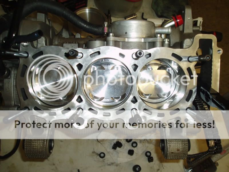

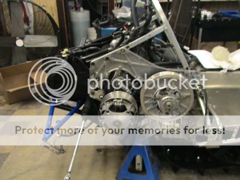

Finally getting some time to continue working on this project.
Motor with JE pistons & Carrillo rods installed!
Also installed ARP head studs. Be careful on the pto top side stud, if you install it too far it can hit and damage the water pump impeller! I measured the depth with a calipers and then measured the length of the stud and subtracted the depth from it. Thanks to Hurrican Dave for telling me to watch out for that head stud! I then used a calipers to set how far it screwed in as well. I installed the head studs with red loctite on the threads into the block and then just slightly snugged them with an allen wrench. Note both studs on the pto side will stick out further than the rest of the studs.
In the process of putting the Air Frame running boards on, this was a 2008 chassis, so the running board angle will change as well.

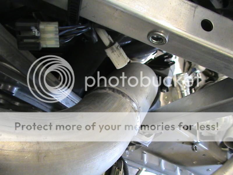

Front a-frames, spindles, shocks all on.
Showing how I routed the large tunnel cooler hoses with the radiator delte kit.

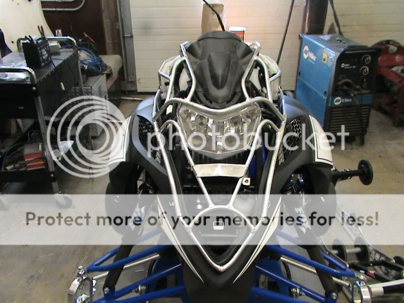

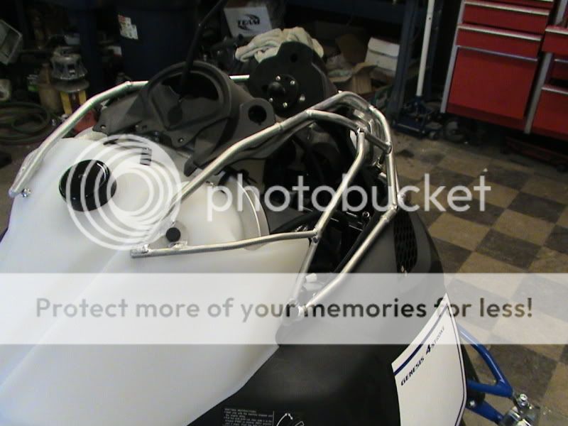

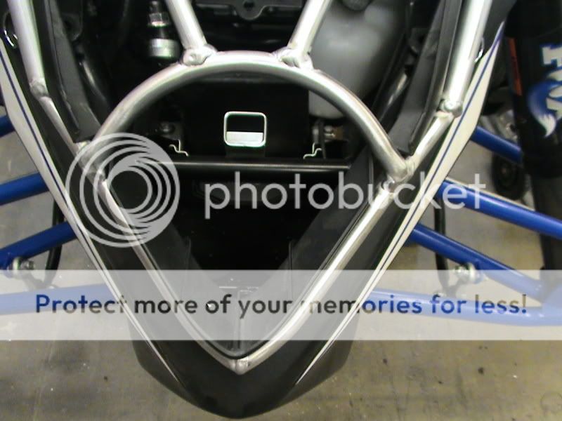

Skinz Air Frame hood. This comes in 3 "sections" and then gets riveted together as one piece.

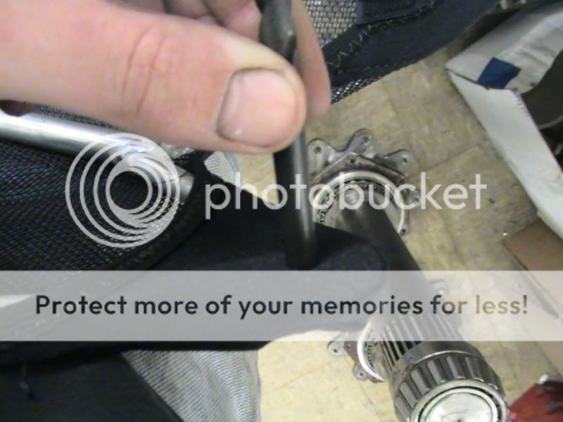

Then you must stretch the hood material over the hood frame and strap it down as well as cut out the holes for the dsuz fasteners to go through. I used a small drill bit slightly larger than the hole and used the back side to cut the material.

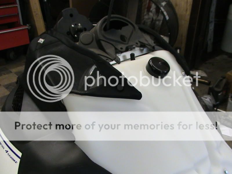

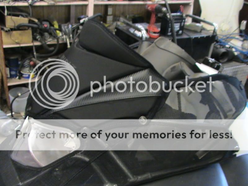

Then I installed the Skinz windshield.
