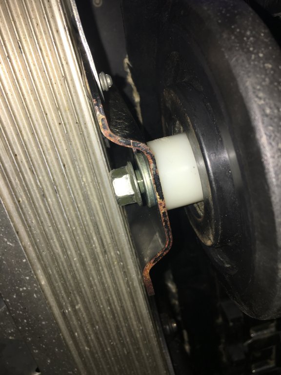

Is it normal for this bolt to not tighten in all the way. It feels like I’m at the bottom of it

Nvm I just put my big boy pants on and got it

The shaft is spinning. You may have to grab the shaft with Vise-grips.Is it normal for this bolt to not tighten in all the way. It feels like I’m at the bottom of it
