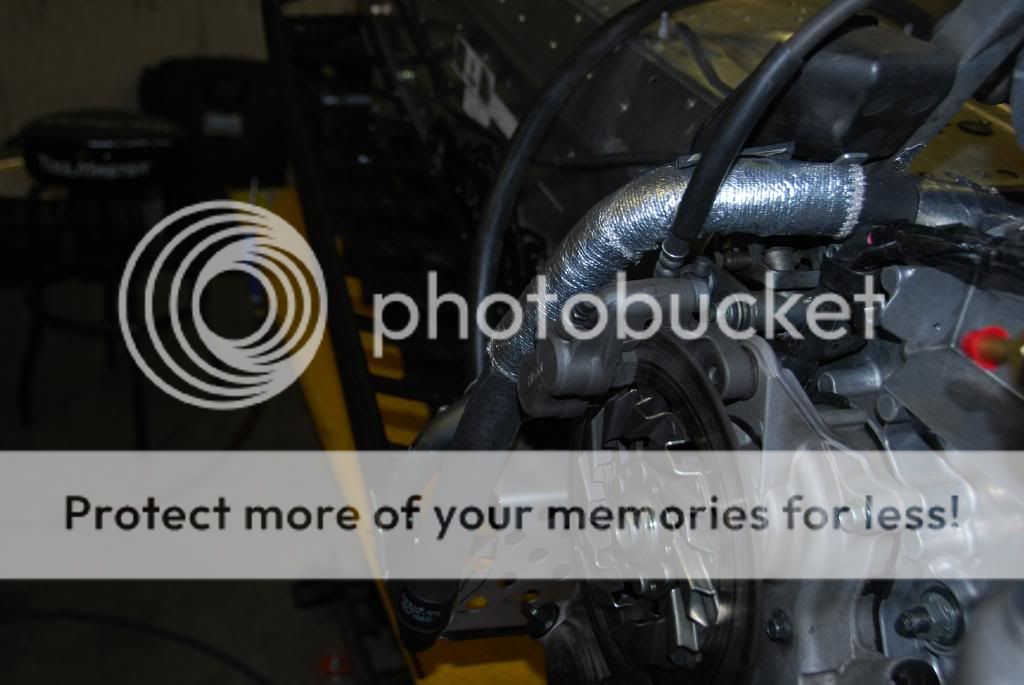

From right hand side hose routing from running board to under tunnel cooler.
The hose may be routed to the front cooler if your plan is to delete the under tunnel cooler.
I decided to retain it for extra snow melting.
Connection to under tunnel cooler.
