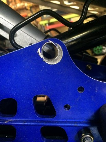

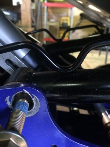

I had a bolt come loose on the pivot point on my rear skid it had worn the bolt hole bad on the rail eventually the bolt fell out. Check and make sure they are tight and have loctite on them I'm waiting to hear back if Yamaha will cover the rail under warranty.

Geez that's no good!! What year of sled are you riding and how many miles? I'm not relating that to a reason, just curious!! I will be checking mine as well next time I'm out there!
It's a 2015 rtx LE 1.7 with 1600km it has the same skid as a AC RR

Yamaha came back and asked me to check the other side to make sure it had loctite one it, the quality control on these vipers is a bit scary, love my machine but it has the same quality issues that all my old cats had.
