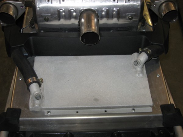

what are you turbo guys using for rear coolers on your turbo sleds.also can i see some pictures please so i can get some ideas.i just extended my 04 rx1 shorty to a 136 . i am using tracks usa rail extensions and the hartman tunnel extensions.i want a rear cooler that is a bolt in . i see the cooler for a 121 is smaller than a 136.i like the idea of the 136 because of the size ,it is bigger .will the 136 work on my sled .i also remember yamaha selling these coolers also ,can someone give me some part numbers please.i want to make my sled run cooler.thanks for any info guys.

Just added the stock Yamaha cooler sled is great with it!!

Anything other than something like this and the track and studs will hit it hard. This is a custom made cooler that started life in a ski-doo. It needs to be mounted above extension to permit full travel of the suspension.
Front exchanger out of an Edge style Polaris will go in without a lot of trouble as well.

skydog what do you mean by yamaha cooler .can you give me a part number and some pctures please.i remember reading a magazine awhile back with yama having some coolers for sale for a 121 and a 136 .will the 136 work even though my sled was a 121 before i converted to a 136.thanks.

Here is a link to the install I did.
http://www.ty4stroke.com/viewtopic.php? ... c&start=15
I used the Yami mountain cooler.
Skydog
Could not find the part number but i put just the added/ update for the 121" works GREAT!!!

Here is a link with pics how I did it with the MPI tunnel extension.
http://www.ty4stroke.com/viewtopic.php?t=33423&highlight=heat
