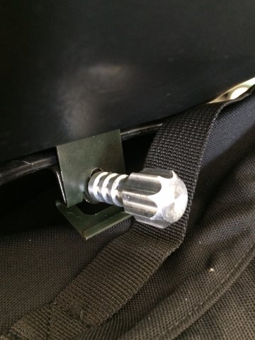

I installed the Race Werx seat bolt so that I do not need any tools to remove the seat.

I had the same seat bolt due to it being aluminum it marred the threads and I had to replace the nut it threads too as well. Nice looking but to soft of a material for a bolt. Be careful threading it in and out.I installed the Race Werx seat bolt so that I do not need any tools to remove the seat.

Thanks for the warning. I do not plan on removing the seat on a regular basis so I am hoping it is fine. I am more worried about rubbing a hole in my large rear bag but I think it should be fine.

Just checked Face Book. Ulmer has a new product listed: 'New SR Viper quick seat removal bolt! $19.95 + shipping. Stainless steel construction, large knurled head for ease of removal.' He also has a picture there. Looks like a good option.

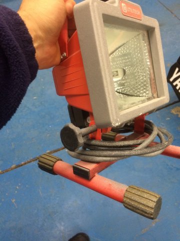

So after reading this thread I went out to my shop and tried to take my seat off ,and low and behold it was a mother hucker,so I broke out a good bit and a ratchet and pulled that thing out and thur it a far as I could.i was planning on leaving it out,but then I saw this (see picture ) and thought something like that would be cool,so I pulled one off and it was the right thread size,took out the cut off wheel shortened it and dab of anti seize ,screwed it in ,done, works perfect took ten min
sView attachment 102494View attachment 102495View attachment 102496
This idea ROCKS!
SISCAKIDD
This idea ROCKS!
That's the idea,has a little meat to it so you can put some torque on it,don't forget a dap of anti seize
