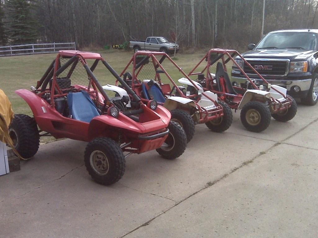

Main reason I asked is I have a Honda FL400 Pilot, and I will probably find a 07 phazer for a donor motor and needed to know actual clutch rpms to see if it would be compatible, which i think it is.
Not the best pic, but the pilot is the red one. The other two are 350s
