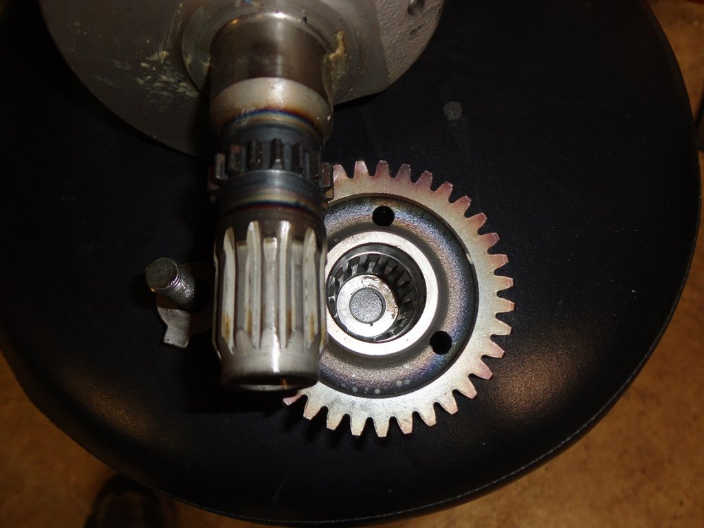

One I have here is just held on with left hand threaded bolt. Splined. Actually a loose fit. Put bolt in and use a puller. Has someone been in there before? There is one spline in gear bigger than others and one groove in crank smaller. If gear was forced on it would be a issue. Gear is clocked to crank in this way.
