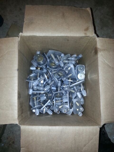

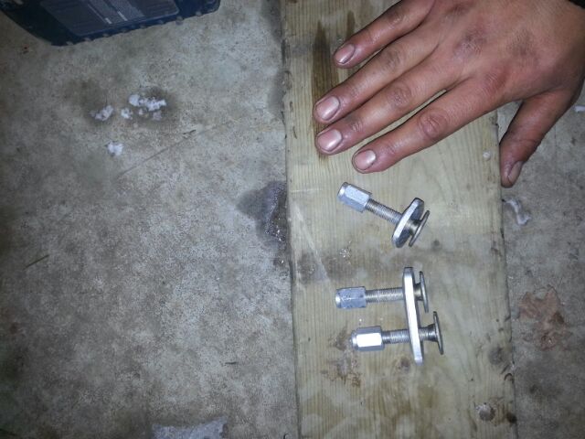

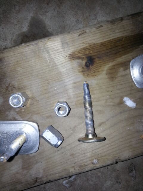

Alright so I spent a couple of hours tonight taking my 2.25" stud boy studs out of my track! Noticed a couple more spots where the studs had touched in the tunnel and feel a lot better now that they are out. Gonna miss the traction but not worth the potential break down. Now the studs were all in pretty good shape with no damage that I could see. No bent or broken studs and no pull outs or tears. I didnt count how many were in there put its quite a few. Anyone know if the studs are worth anything even though they are used?
WarriorWithin

Yes you can sell them but the problem with yours are they are so long only snox guys will only be able to use them or want them. I had some guy buy my 1.325s and put them in a ice drag car. Pretty limited interest
