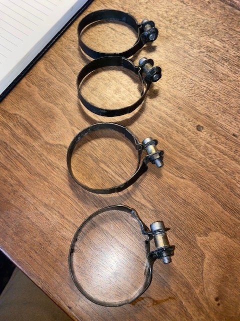

- 2006 Yamaha Apex GT
And are these hose clamps that fasten the rubber boots of the airbox onto the carb inlets, are they supposed to have this bend/crimp in them; note first picture with the pen pointing to the "crimp" I'm noting. Other pics shows 3 of the 4 this way to varying degrees, the 4th is mangled. I think a butcher owned this before me; (all due respect to butchers out there )

Yes, those are the clamps that go around the rubber boots on your air box. Notice the little U-shape notch on the clamp. On each rubber boot, there is a rubber dimple that goes into the notch. As for getting to those bolts, this tool set would bode you well.
