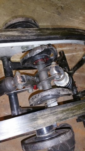

Metallicat
I use a flywheel puller.
Italiangreatone
- Oct 13, 2015
- 61
- Massachusetts
- 2005 yamaha rs vector
Great. Thank you
Metallicat
Remove the wheel first, then use the puller on the bearing. The wheels are just held on by a snap ring.Great. Thank you
