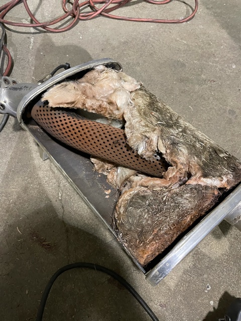

I got the can cut open with an angle grinder and a cutoff wheel. It's definitely a packed muffler. The factory packing was pretty wasted. There wasn't much left of it.
It looks like there was probably some steel wool packing in the can originally with fiberglass packing but its pretty much blown out. All this debris must have been what I heard rattling around when I shook the can.
I removed all the factory packing and inspected the flow through tube for any issues. It's in great shape.

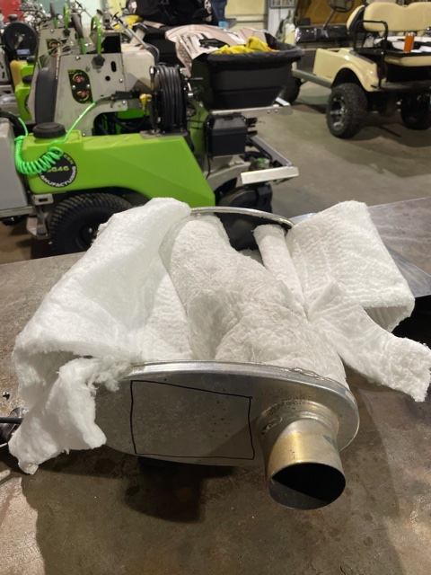

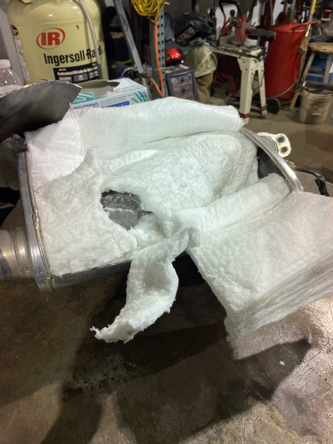

I ended up repacking with a kit from International Steel Wool Corporation. They are located in Roseville, MI just outside of Detroit. The Muff Pack kit I ordered came with a stainless steel wool mat that gets wrapped around the flow through tube, a stainless mesh that gets wrapped around the steel wool, stainless mechanics wire that gets tied around the mesh and the wool to hold it tight and ceramic mat packing the wrap around the wool and mesh as well as to fill the rest of the can. This is the link for the kit I ordered. It was $44 with free shipping. https://shop.steelwooldirect.com/product/muff-pack-carbon-fiber-muffler-repacking-kit/
It comes with ceramic packing mat instead of fiberglass. It's rated to 2600F instead of 1150F for fiberglass and is supposed to last longer. Their website claims wrapping the flow through tube with stainless wool and stainless mesh, then packing with ceramic or fiberglass will make the packing last 4 to 5 times longer than packing with fiberglass alone. We'll see on that I guess. I probably won't own the sled long enough to find out.
I forgot to take a picture of the stainless steel wool and the wire mesh when it was wrapped around the flow through tube but in the above picture you can see it a little. I wasn't sure how tightly to pack the can. I packed it what I would call in the middle. I definitely could have packed it looser but I also could have packed it a little tighter as well. I used all the steel wool and stainless mesh and about half of the 1/2" X 24" X 60" ceramic mat.
