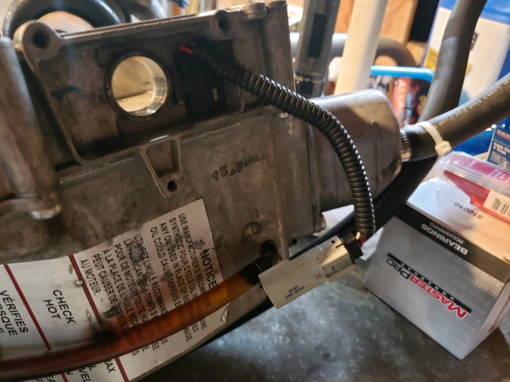

The magnet and this sensor that is glued onto the chaincase.
View attachment 162977View attachment 162978
Is that sensor and magnet what operates the reverse alarm or is there something else that energizes it when there is a fault and the ECU starts throwing codes?
My tunnel was also replaced this year - the shop fixed both that and the voltage regulator issue at the same time. Since EVERYTHING was torn apart, it would make sense to me that this sensor may be the root cause.
