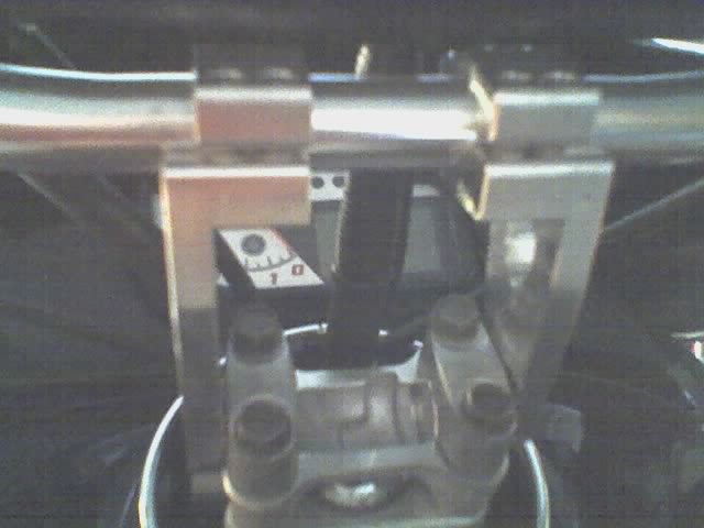

Yea, it just allows basically 2 pivot points to get you more rider forward. Good looking risers too.

gukrokit-- how big is that riser and what bars are those ?? looks sweet !!!
GUKROKIT
It's the rox 3 inch with aluminum bars from a yz125 dirt bike.Overall height same as stock 03 rx-1m,just wider and straighter.Allows use of stock cables plus great added control and leverage.Can be pivoted forward a few inches.Excellent compliment to the wide a-arm kit!Riser$80 bars65$Tricky part was hiding all the wires in that little pad!

NY warrior- I should have specified that my riser worked with stock cables because Ive got the mountain with long stock cables...
Gukrokit-- Did you cut and splice any of the wires inside the foam pad. Or are they all stock ?? What year yz 125 are the bars from ??
