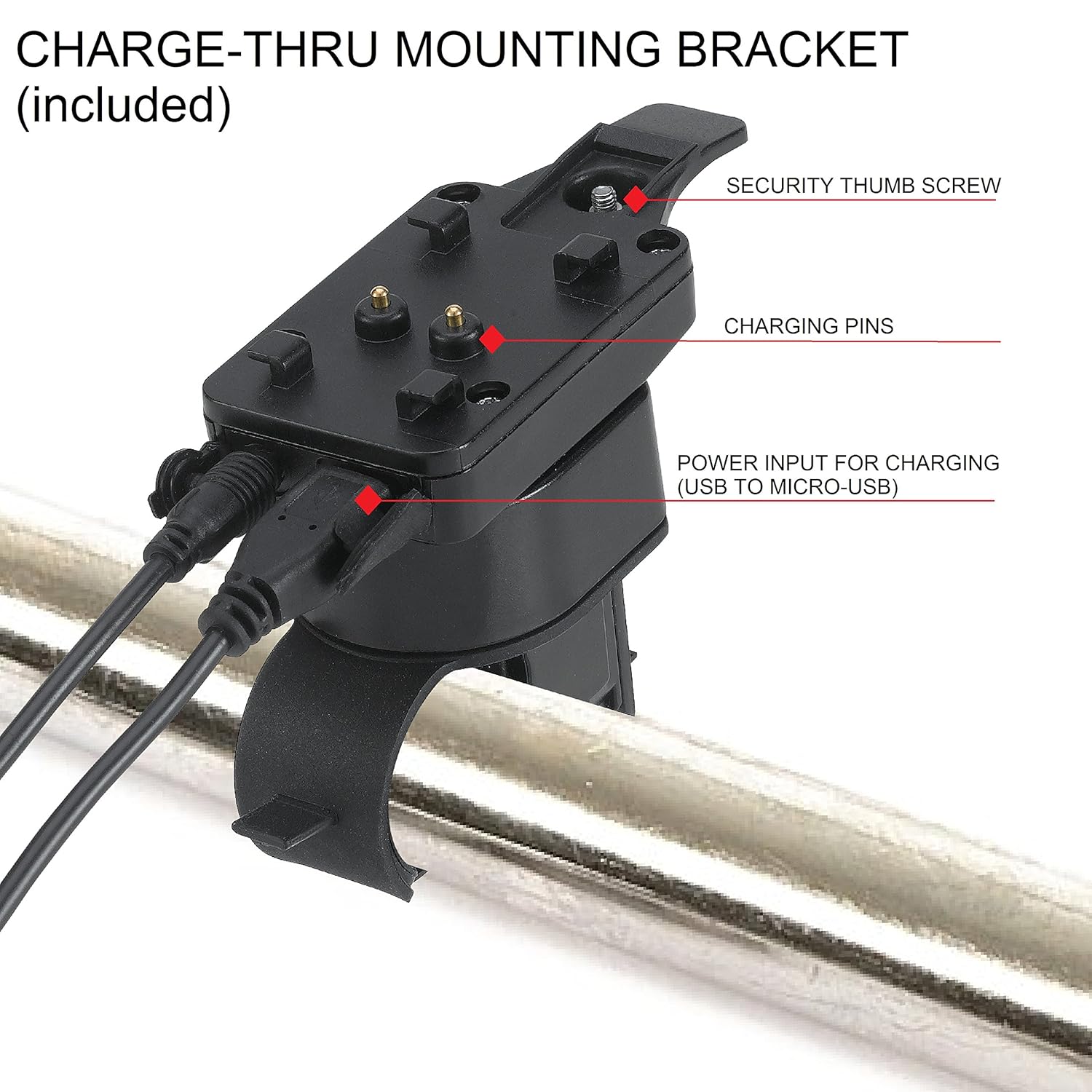

Anyone putting one of these on their sled? If so is it plug and play for the winder? What does it connect to? I'm looking for a solution to plug my phone in so I can use it as a GPS w/out it going dead.
The 12v cigarette socket is going to be used with my RideLite. The cat connector by the chain case will be used either for a heated shield cord or when not using the shield my blue led lights. So I either have to use one of them cigarette Y cables or go w/ the smart supply (maybe)
Also if anyone wants to know how I plan to keep my phone safe I am using this case:
https://www.amazon.com/gp/product/B00YFCFN24
Phone is fully sealed in the case. It uses gold contacts to the mount to change the phone. I also got the AMPS adapter plate so that I can attach it to the bars with a RAM Diamond mount.
https://www.amazon.com/gp/product/B00HUVZ1FQ

I don't see why you couldn't use it in a bag. The case uses a micro usb connector so make sure you're phone has that type. It would keep your phone safe and dry. I don't know how much bouncing around it would be doing in a bag. The only thing I could see happening is the micro usb coming unplugged from the bracket thing.
To reduce the space it takes up you can remove 1/2 of the back plate from the mount bracket. In the pic below you will see 4 screws that hold the AMPS mount plate there. On the std. model You would have like a strap there that would go on the bars (I don't know what I did with it so I can't show it). So remove the 4 screws and you will have 1 more screw underneath that is for the swivel. Remove that as well and there you go. I have attached a pic showing a Galaxy s4 in the case with all the little filler blocks set for it. Also showing a pic of a note4 on it, showing that even a big note4 will fit. NOTE the plastic hinge closer of the case is a bit flimsy so be careful with that. The side opposite of the closer hinge gets closed first then the hinged side. It kind of fits into a lil groove.
