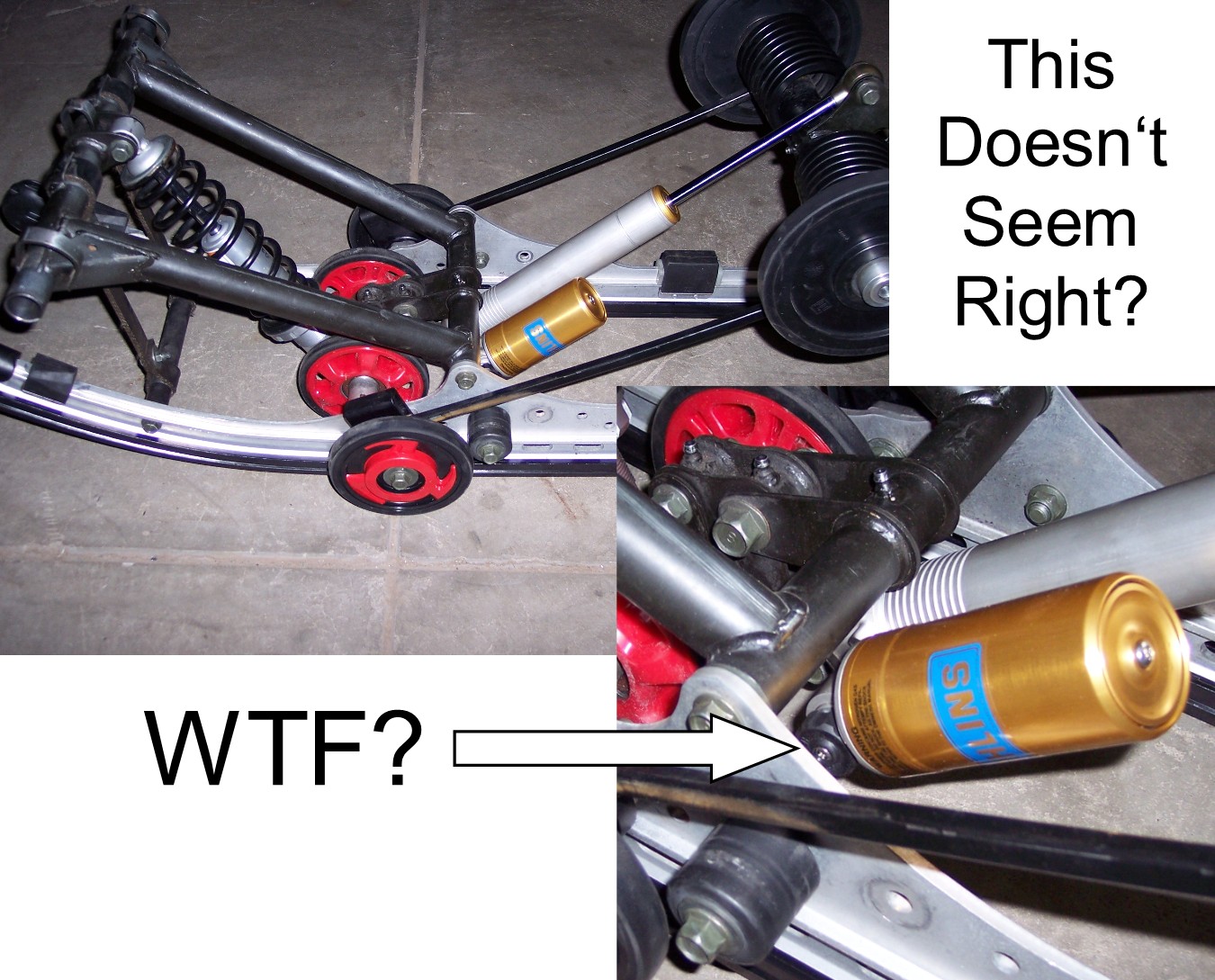

Hey SKIDOZER & REAR2HIGH:
How did you guys mount your Ohlin? I'm finally installing the one I bought a few months ago...
It seems like the piggyback has to be mounted down. In this configuration, the clicker knob is almost impossible to access because the slide rail & bump stop are in the way.
Thanks, Greg
Thanks, Greg

garserio said:Hey SKIDOZER & REAR2HIGH:
Thanks, Greg
To follow up with my original message above, here is a picture of the situation:

garserio you have the shock mounted the correct way, and yes it is hard to adjust the clicker

MJ_SXR6 said:garserio you have the shock mounted the correct way, and yes it is hard to adjust the clicker![]()
Thanks for the confirmation...
The only idea that I could come up with is to make a new knob that can be turned with a screwdriver or some other type of key. Then remove (or move) the anti-bottoming stoppers so that key/screwdriver could access the knob.
Maybe this adjustment issue is a good reason to consider the stock 2006 Nytro rear shock?

Where have you guys placed your anti-bottoming stoppers after putting in the Ohlins shock?

Have mine mounted the same way, not real easy to adjust but can be. Hopefully get adjusted just right and forget about it.
SKIDOZER
I mounted mine the same way,thats the only way it fits, i have my bottom stops opposite of garisaio so they contact later in the stroke,
I can turn the dial with no gloves but will be imposibe when iced up.
what about drilling a hole infront of screw on clicker and using a screwdriver?
Im still much happier with this shock and revalve its a whole new sled again I will find out more when the trails open here after deer season.

Maybee we should contact ohlins ,and have them give us a knob that sticks out farther, for $450 you should be able to acess it.
dont think a hole would work for screwdriver based on photo above to close to wheels

Shane, I have mine mounted in the front hole. Gives me the the right feal after the suspension squats a certain amount, almost like having heavier springs for the last half of travel.
