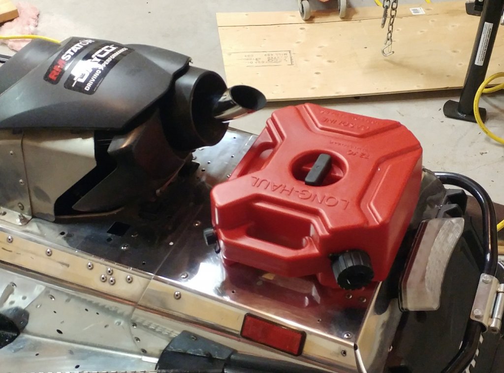

I toiled with this several years ago and ended up putting a trail tank on. I think you did a brilliant job with the aluminum bracket that extends upward to allow the tanks to be mounted upright.
Did you go to a metal guy and have him cut the aluminum with a plasma cutter?
Nice job.

Thanks! I was set on the trail tank but I was thinking this would be more versital for a little over a third of the cost.
I made the brackets myself. Cut them from aluminum I had on hand with a jig saw and then finished them eith a sanding flap.

Looks good...you did a wonderful job of mounting them !!!!.....what brand of can are they ?.....do you have a link for ebay item ?...thanksEach can is 1.3 Gallons. The mounting is really strong, no flex or movement at all. I am really impressed.
Some of you will note that this is not a Rotopax can. I ended up finding these black fuel cans on ebay and I liked them much more for a couple reasons, mainly the fact that they were black and blended in better with the sled, but also they carry 1.3 gallons vs the 1 of the rotopax I was going to purchase.

The brand is Long Haul. They are made in China and I was concerned about quality when I ordered. They are very heavy duty, very thick and overall I am happy with them and I would buy again.

Do you believe these are the same cans?
https://www.ebay.com/itm/2x-Gas-Oil...ash=item4b2cf0633a:g:YZoAAOSwvR5aCdrS&vxp=mtr

Those are the same ones.

I like the idea on the brackets. I had considered that but was hesitant on how they would turn out. You have confirmed they look great. Nice workmanship. And no fancy tools I gather.

Thanks for the comments. These are easy to make, I have about an hour into them both.
I really like your mounts. Nice and clean install. I like the black cans also. I plan to do the same for mine. Still contemplating the 1 gal to 1.75 gal cans.

I agree Dirt, I like the black cans no matter what... nice twist on retainers too... regardless, I am holding off on any can mounts other than a 1.3 gallon on my rear rack until I see if I really need it. I think there is a lot of "look how much fuel I can carry" syndrome going on if we are honest.... I have a 10+ gallon trail tank times at least 12 mpg (maybe 16mpg) and how many times have I driven over 120 miles before lunch and usually that lunch stop has a pump. We do have a few trips in Maine that can challenge our gas tanks up North but often you have passed a gas pump or two if you end up on "E"... I am still leaning to a 1.3 on my rear rack and if I ever have to dig into it, my bad or laziness for not filling up at the last stop... or borrow some from my brother in law's 10 gallons on the back of his new freeride : )
