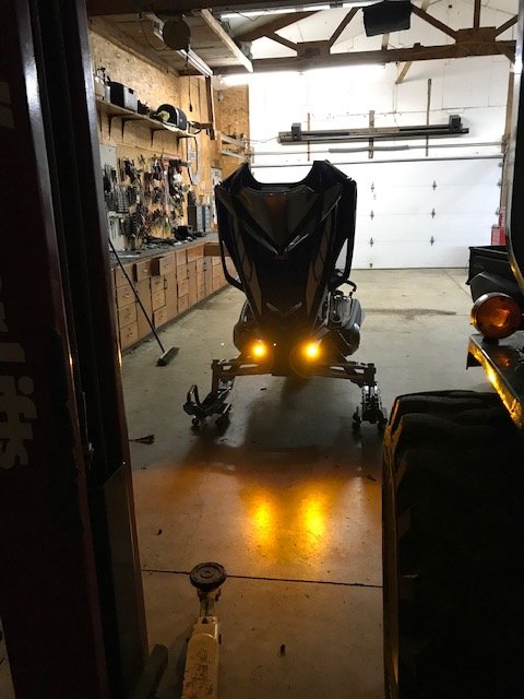

Got the coils and the plug in seems to have better throttle response and starts better. Pivot riser and WRP seat should be here tomorrow. Got bored and installed rider alert lights in the front bumper. Got them on green and yellow toggle switches so I can tell which ones are on. Getting the power from battery tender plug so I can unplug anytime. Fairly simple to do just took some time. The LED's are bright.
