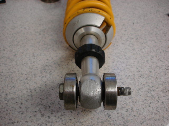

The only downside to having studs in the center of the track is that the heads will rub on the rear eyelet of the shock as shown.
After seeing the wear on the shock eyelet I added the anti-rub kit from Ulmer Racing as shown.

I added the anti-rub kit (two bearings and a longer bolt) after I noticed the problem. Had I put the anti-rub kit on right away my shock would not have experienced the wear shown.
