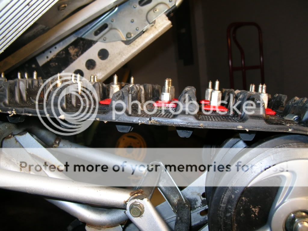

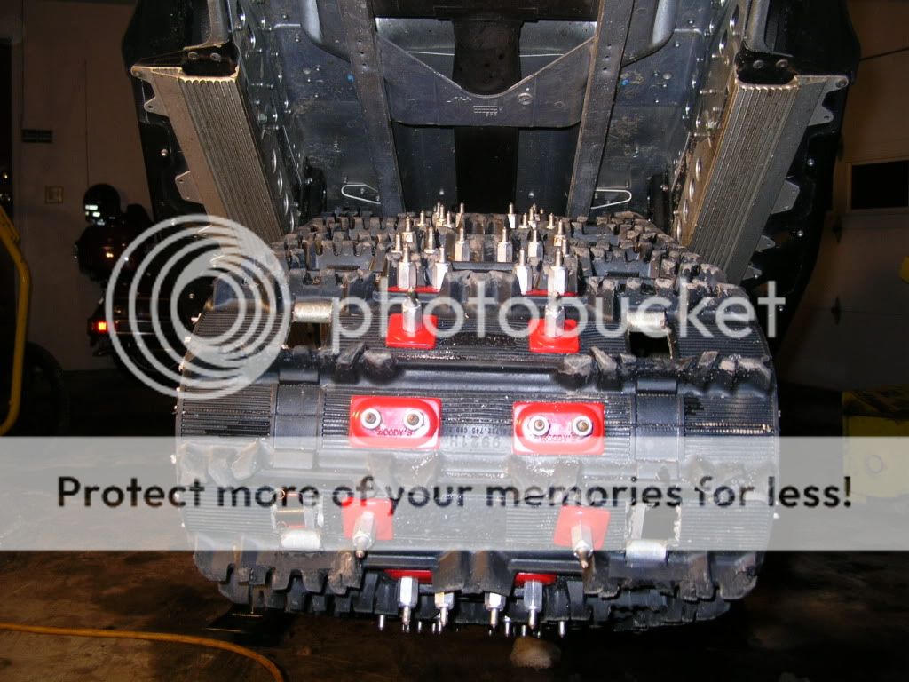

Capt.Storm
3500 miles..no probs.
I like the tall nuts.
If you look close you can see the one short nut.
