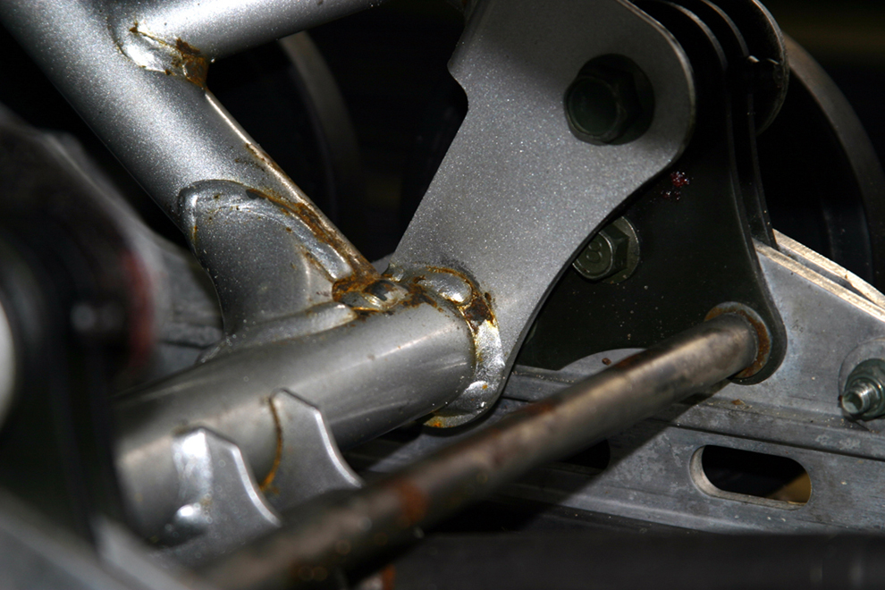

For those of you who think that the rust is coming from flexing of the Arms at the welds are way wrong. My dealer ordered new arms to replace the existing arms due to leaking grease fittings. The Arms came in today and before the Arms got installed I wanted to see if the new Arms had the grease fittings welded all the way around the fitting because if not I'm sure the new ones will leak just like the old ones. As I was checking the fittings I noticed rust on the welds in several different areas on both of the Arms that were ordered. Upon further inspection I could also see small cracks in the paint. These suspension parts are brand new wrapped in foam and sealed in plastic. My conclusion is that the rust on the welds is a result of improper prepping of the welds prior to painting. Welds when done properly are harder then the material they are welded to. So if the Arms are flexing they would not only flex at the welds but around the welds as well. From what I can see on my sled the paint is pealing off the welds, and only on one of the Arms. The other Arm has almost no rust on it and the little it has is slight surface rust. If flexing was the cause of the rusting, both arms would be experiencing the same problem, take a close look at the pic’s. I’m sure that a good sandblasting job, proper prepping of the welds and Powder Coating or Ceramic coating of these parts will solve most of the rusting issues. IMO
And by the way the grease fittings on the new Arms are only welded in one small spot like the old ones.

My 06 pivot arms and all of my buddies pivot arms looked 100% perfect when new. There wasn't any paint flaking anywhere.
After a few 1000 miles paint was flaking of at certain welded joints and by 3000-5000 miles small cracks were visible in the locations that first started to flake off.
The rear arm cracked on my sled and one Apex, but the front pivot arms cracked on my sled as well as on 2 out of the 3 Apex I ride with.
I should mention that the Apex with cracked front and rear arms was missing the front bump stops for the first few 1000 miles - this very likely put much higher loads on the arms when bottoming out. My sled had firmer than stock shock valving which also would put much higher loads on the arms. The 3rd Apex with the cracked front pivot arm had high miles on it before small cracks started on the front arm only. We were also all running the heavy spring.
It sounds like your new pivot arms weren't prepped properly, but on ours the paint only flaked off at the higher stress joints. The lower stress joints (95% on the rear arm) don't have any paint flaking or corrosion at all.
Actually we all had minimal corrosion (even on the cracked arms) because our sleds are trailered in enclosed trailers and our suspensions are sprayed down with WD40 and greased regularly.
I reported at the begining of the season that my control rod had rust on it when they took my RTX out of the box in September. I also know of others who ordered mono shock pivot arms and found rust on the welds right when they were unpacked. I know some people have had cracking, but I think most of the rusting is from crappy prep work.
