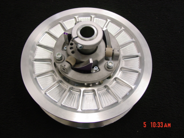

OUCH, you can have a real secondary for 545.00

Ted - That's a real secondary, is it the Tuner from STM? If I were to buy one of those, what additional cost would there be setting it up for my turbo sled? I guess I will have to add a helix and spring to match my sleds power.
That's it, just a helix and spring, I don't know about where you are, but around here guys have bucket full of Cat helixes and springs, so you can borrow till you find what you like then buy.
I have a starting point, Green Cat spring and 50-40 helix for flat landers.

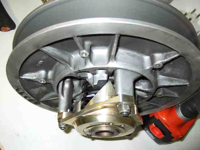

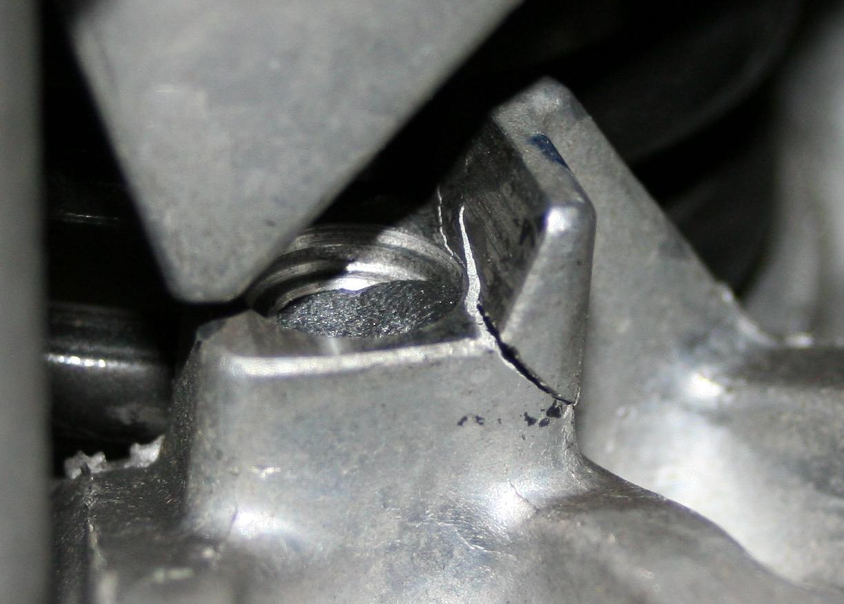

Here are some pics of my secondary sheave that i promised.

i had the same thing happen on my 05 as far as the ramps breaking. i honestly didn't even try to make a claim under warranty, i already had a team sittng in the garage. So i just set up the team and i like it now, but i did notice a few mph lose. i've had the team secondary on for 2-3000 miles so far with no problems.
It was the ramp in my '05 secondary that was breaking, in 2005 they still had the under engineered button ramp. The sheave in my picture is the replacement part, the partno for this part is the one shown in Yamaha parts catalog from model year 2004-2008. In 2006 they got the new sheave partno into production.

Guess I had about 2000-3000 miles on the secondary. Remember, I ran it in my turbo sled at 285 HP, that did stress my secondary way beyond what a stocker would do.
Around 4800 miles I think. I climb alot so perhaps that can have somthing to do with it. Full throttle, off throttle, full throttle... :-) Still it should hold up.
