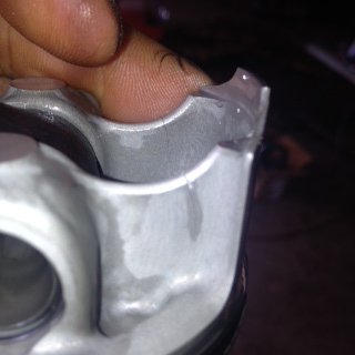

Wrist pin not broken, can't se any damage in the other pistons and rods
I don't know what have caused the broken rod
Can't see you other pistons close enough but have a good look - this is one of the pistons I've removed that had cracked

The three pistons that is not broken have the same crack, and the one that is broken, is broken in the crack. Add some picture of the bearings also

Thats definaltly the piston that broke, same as my buddy stone's motor when it let go - the new style pistons definalty aren't as good for boost. I'm curious too, how much boost do you normally run.
