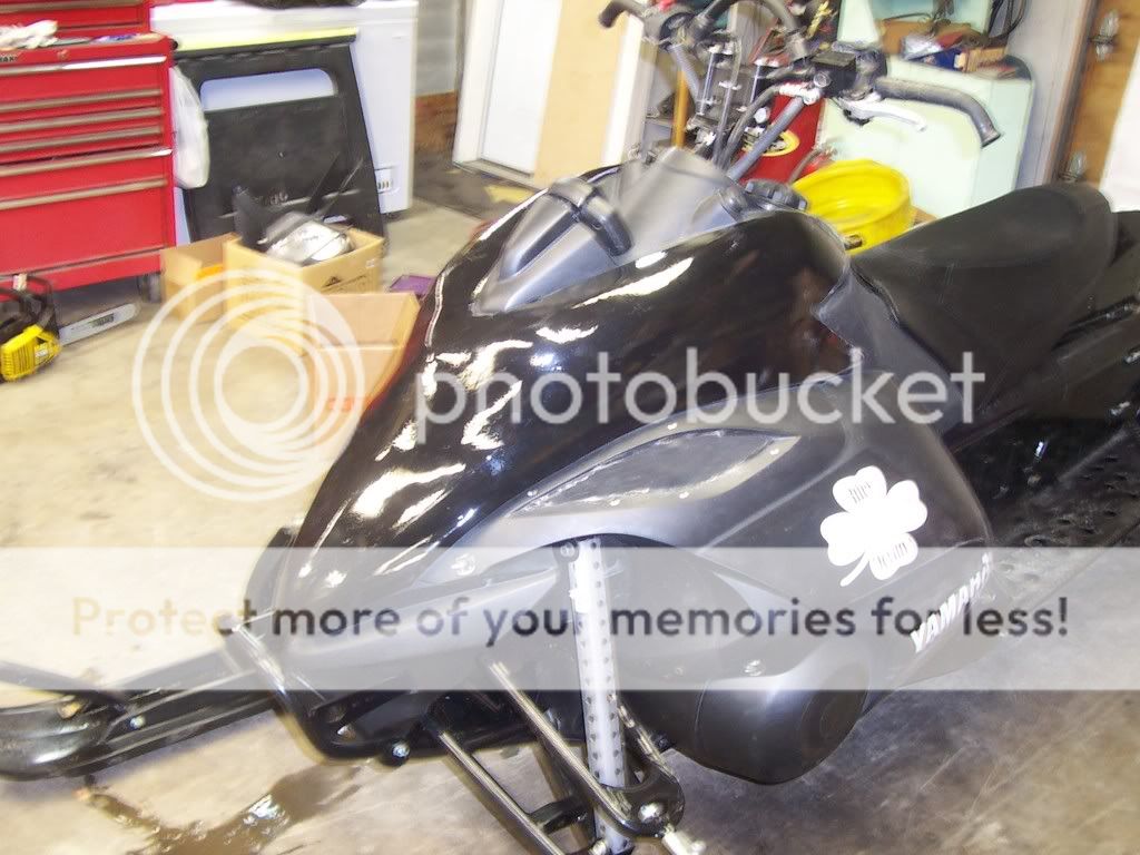

Installed my new beautiful shocks today and started installing the header.
Float X's from the Nytro RTX SE...I also got my new lower a-arms on and installed the new updated ball joints.
used Excell Vector header
The Nytro and vectors headers are obviously different in the way they mount. The slots don't quite line up so I had to do something different.
Installed 5/16 nutserts from the local hardware store
Removed the stock header mounting bracket and drilled two new holes for the 5/16 bolts
Then made same 1" spacers out of an extra radius rod to go between the top of the tunnel and header and then ran my bolts through and tightened the header up.
Header centered in the back. I just need to weld a flange on tomorrow for the exhaust and then I can finish up the seat brackets and tunnel enclosure.
