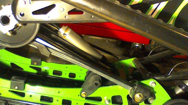

Perfect!This is on a cat snopro 137' . Did the same modifications . The kit is for the 146' but you could adjust for your type of rail. You could see the differences on list parts between 146 and 137. The major modification is to extend the groove in the leafs.

Installed most of this last night. Not sure if I extended the groove enough. I cut it just enough that the spring would mount into the existing hole plus maybe 1/8" or so. Used a drill bit and a file. Took out maybe a 1/2" or a little more. It fits.
It also appears I need to relocate the black plastic activator by drilling another hole into the rail. Not sure where tho.

Any pic?

Is it because you not able to put the leafs down?

Ok to anyone who had done this I have some questions as I am modifying mine right now. On the leafs how much did you slot them I think I am a little over an inch and they will still not lay flat in the down position but I am worried by continuing to slot I am dramatically weakening the leaf strength. Then my next question is did you relocate the activator as if you use the hole in the frame it does not drop over center so when the spring engages it just pushes the activator over and defeats the purpose. and then finally should the leafs be in contact with the torsion spring when in the up position? Mine is still a couple of inches from making contact? If you have done all this does it work well or am I better off doing something else. Thank you for any input.

Snowbound98 thanks for the info. My issue it this is for the wife on the back not kids, so the weight will be a little more. I am curious if anyone has actually done this and how it worked. I see the one picture of the artic cat and it looks like he just drilled a hole for the cam over, which I could easily do, I would think just move the cam on the rail in the up position and then mark the hole. Just wondering if I am wasting my time though and should just get heavy springs. If I understand you just increased the stock spring didn't purchase new heavy springs?
