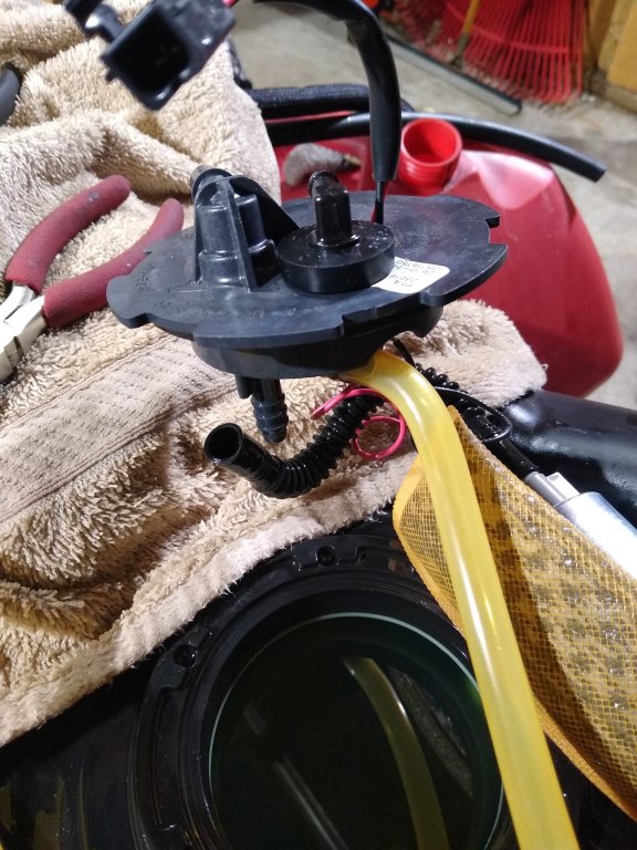

I just put a TD fuel pump in a buddies sled and it had an oitiker clamp on both ends of the supplied flexible hose.I sure am glad I tested a few miles from the house. Could you imagine this have been in 0° temps and having to try to do this outside. Sorry guys, my bad...

Was it the plastic line or rubber?I just put a TD fuel pump in a buddies sled and it had an oitiker clamp on both ends of the supplied flexible hose.

No, it was still attached. Basically it was hanging off the last Barb.Was the fuel line off when you opened it up?
I reinstalled it, hit it with a dose of heat (to further shrink) and now I will add clamps.
Thoughts ?
Jon, my fear is I did not heat it up enough. When I installed it I couldn't get it soft enough to go all the way past the top Barb.Wondering if you heated the plastic to much when installing ?
That flexible plastic is very delicate.
I haven't added the extra filter yet. However I do understand the advantages.Just spitballing, did you add a fuel filter?

I was able to reattach and then reheat the area in hopes that it would bind better. But I'm going to the store to get clamps.I just put a TD fuel pump in a buddies sled and it had an oitiker clamp on both ends of the supplied flexible hose.

SNUG on the clamps.. Not torqued to shi^%.. Its plastic not rubber so you cant go crazy with the clamps.. Goes without saying, just saying..I was able to reattach and then reheat the area in hopes that it would bind better. But I'm going to the store to get clamps.

Myself I wouldn't be using that plastic hose even with clamps, but thats just me. I like the submersible rubber hose with a clamp that is going to hold the rubber decent.
I'm not sure putting a clamp on that plastic is going to seal it up. Heating that plastic and expecting it hold the pressure IMO is a hit and miss. If it come off on a trail ride there you are broke down on the edge of the trail. I've not ever had a submersible rubber hose fail or come off, just my opinion.

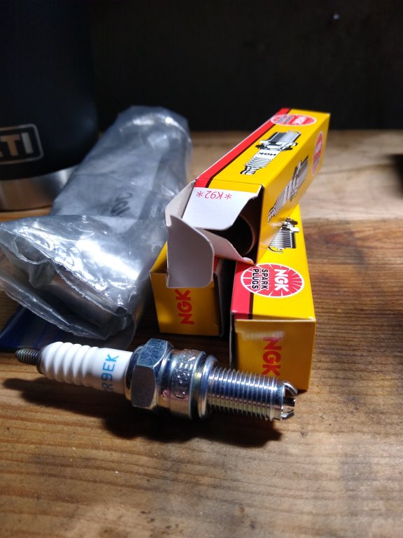

Knapp, do these get gapped?

Yes they do, td recommends. .020
I run them at the factory gap of .024"-.025". I've had no misfires with them in many years at that gap. I've not seen a need for less gap that with less than 320-330 or so HP. In the old days with some sleds with weak ignitions it was needed, but I haven't seen misfires on the 998 yet, not sure why TD would recommend it myself for trail use tunes.
If you desire to gap them tighter approach with caution, if you gap them less than desired, you don't want to then open the gap up by prying against the center electrode and cracking the insulator. NEVER PRY AGAINST THE CENTER ELECTRODE!!!!!

If you do gap them to .020, tap them on something hard like steel and check and repeat. I gapped mine this year, but never had a misfire either at stock gap.

Left factory gap at .024 for this low boost application. For reasons Knapp explained. I didn't install the plastic flex line to the pump lid correctly, my bad. I'm a little wiser today. no harm, no fowl.

if you dont mind taking apart again... get rid of that plastic hose and put submersible fuel injection rubber hose on with clamps.

I got this....lol. I ordered more of it so I can get practice.if you dont mind taking apart again... get rid of that plastic hose and put submersible fuel injection rubber hose on with clamps.
