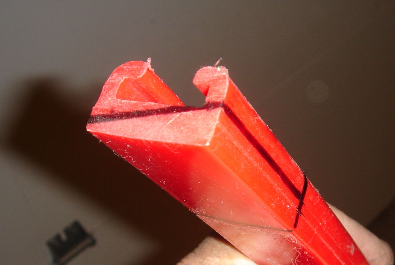

Sorry, I was gone all weekend. Just saw this. Hope this'll help!
-Al
hey hicks, how thick did you make those shims?
X-2, how thick is the thickest, (back), part of your shims? I like the tapered design. And the length is just the width of the hyfax, correct? Wonder how these will work with 8" Stud Boy Deuse bars?
