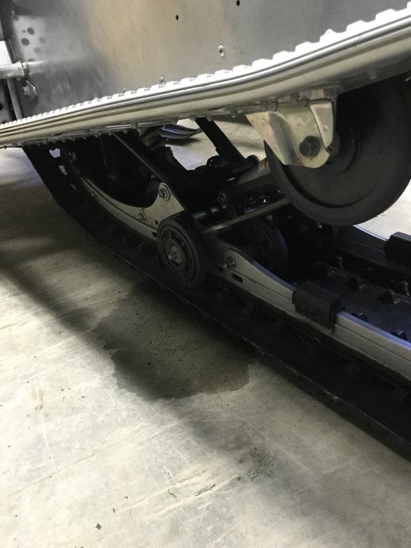

I've been told theres no way of getting seals & such parts for it, any truth to this?
Was thinking of checking in with HyGear on fixing if my regular shock guy can't cure it. Wondering if any other shock brand options out there fit?

Parts are readily available. Just get it rebuilt or swap for a different shock for maybe $50 more. I believe its same length and travel as Phazer center shock and was many Fox shocks from Polaris that worked good in those.
