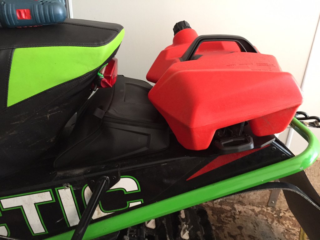

I purchased 3 different linq adapters to find the best fit .
The UpNorth universal , and the original LMP-1 , and the Whiteout adapter.
I took off the stock tunnel bag on my LTX LE 137 , and installed the bigger removable tunnel bag , so I had space issues .
I decided to install the Whiteout brackets as they allowed me to raise and get the Linq gas tank , as far back as possible, and used spacers to raise it up , so it would not hit the tail light assembly.
I installed the universal adapter , and my stock tunnel bag on my sons AC 6000R , 129 ,as he had no tunnel bag on the race sled and he is the one that always needs gas .
I have attached pics to show , the install on both sleds
And the Yamaha tunnel bag covers the Skidoo logo on the SW.

Keep that extra weight forward.

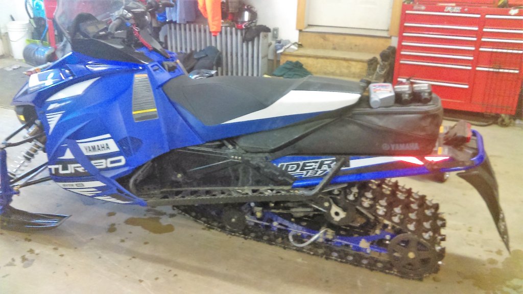

I like the Yamaha patch you put on. I just ordered mineView attachment 128103 On a 137 model I would recommend keeping the weight of a fuel Caddy more forward and the storage bag in the rear. I have put over 3000 miles on my winder this year with fuel caddy as close as possible to the front with no issues. (Shown in pic). But we have had 2 customers with fuel Caddys mounted to the rear show signs of tunner wear with loose rivets at under 1500 miles.

This is a sidewinder listed exspandable bag,much like the one up top who has a roto pax loaded into it,now I like that idea. Mine is sma-8ly63-00-bk and works good,but the funky steel plate that this cat chassie has to mount the seat to,well cover that spring type plate with tape,or it will wear into bag.

I have the same bags on my Viper and the seat bracket cuts into the bag...I had to put several layers of duct tape on the bag where the seat bracket hits. It had worked a hole through the bag on the first outing. Secondly and worse for me was the hooks that attach to the bumper scrape the paint off the bumper which P... me off. Now with the Doo bags I won't have this problem. I'll call them Yamaha bags once I get the decals on lol...
