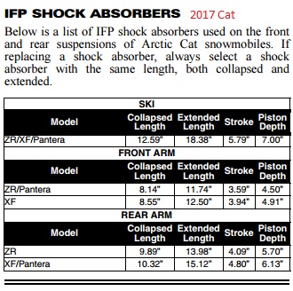

Been scouring places like eBay lately on QS3’s and other shocks for my Stx-Dx. Not every seller says what it fits or what it came off of.
So that being said, does anyone know the length needed for front shocks such as 40” , 42” etc.??
Same goes for rear shocks.
Any other important info would be great to.
Thanks!

You are riding a cat with cat shocks. Match your model Yamaha with the Cat model and these are your shock lengths
