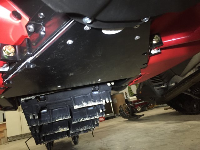

Alright. My dealer got in a Viper rear plate and it will work on the winders with a little modification. They have not performed it yet. I had to ok it tonight before they went ahead and started cutting a $150 skidplate. From what they could tell holding it up, all that will need to be done is to cut the 2 front tabs off and to widen the exhaust hole a little bit. Possibly new/widening of the screw holes in the plate as well. Once complete and I finally pick the sled up I will try to post a cpl pix and let you know how it turns out. My best guess would be next week, as they have to order a 2nd one for my Dad's sled. Here is a pic showing the ares in red that will need to be modified.

Finally got the sled home. Here are a cpl pix of the skidplate
Where they cut by the exhaust is still kinda close. When I get around to it I think I will trim that area a bit more. Also going to add a few small holes in the ribbed parts so any water that ends up there will drain.
