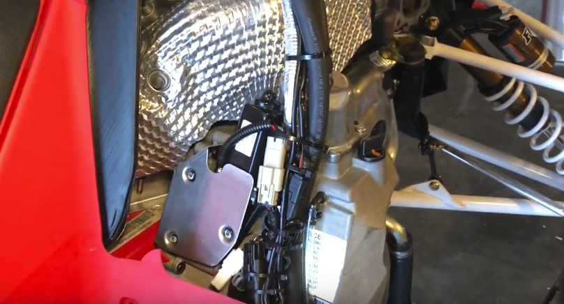

@race24x
As you are sitting on the sled, its under the right hand side panel, on the back of the chaincase cover.
The reverse motor is the black part under the silver plate you see here.

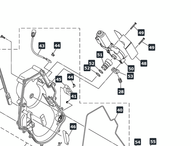

The parts referenced are here
53,51,43
Full parts diagram here

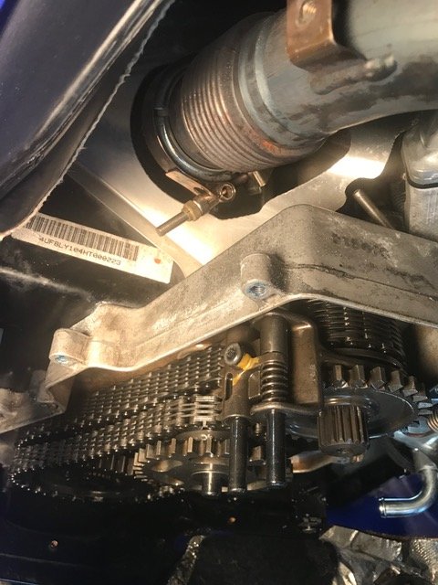

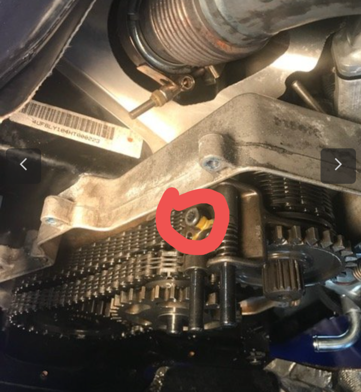

I think you are correct as to what Race24x was asking. Just to be clear, this is the magnet on the rack that you are referring to? This is what you clean when the chaincase is open?

Yes your red circle identifies the reverse beeper magnet which moves on that reverse rack when going from forward to reverse and so forth! I would have to look at the electrical diagram to see how this may or may not tie in to forward or reverse status! I do know that when my reverse beeper failed, the pod still showed an R when in reverse! I was just trying to clarify the sensor & rack mentioned, but not sure that’s Race24’s problem!I think you are correct as to what Race24x was asking. Just to be clear, this is the magnet on the rack that you are referring to? This is what you clean when the chaincase is open?View attachment 175396

The sensor is 43 in the diagram, the magnet is the trigger. The magnet is what is going to attract all the junk. All of it is controlled by the ECU so there is not much of a circuit to look at in the wiring diagram. There is a specific 'reverse alarm' wire from the ECU, this could be managed either way, it could be an input to tell the sled what position the actuator is in or it could be an output simply to drive the alarm. Probably the former.
