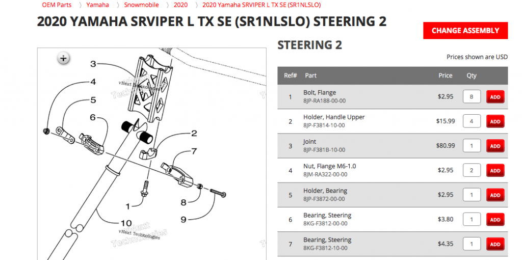

mainedrummer
- Apr 13, 2019
- 149
- 113
- 353
- Up North
- Yamaha Sidewinder
This part number is for 2014 - 2016 Vipers
The 2020 SW and Viper both use OEM Part Numbers - 8KG-F3812-00-00 & 8KG-F3812-10-00
WTF?!

sadly, i have run into a few instances where the yamaha part number on the website was incorrect, or a certain acessory did not fit my 2020 xtx se....right on the yamaha website, luckily my dealer took back the 400$ part.... I have also seen where a yamaha part number gets superceded to the point where when you order something and something unrelated shows up (think shock bushing and they send you a chain...). it is the reality when a company does a mass update to part numbers/revisions unfortunately. Hopefully everything turns out for you Maine, A competent machine shop should be able to whip something up cheaply for you, and at worst, drop me a DM if it doesnt fit and you dont want it, ill buy it from you and machine something to make it work.

Maine, part number 7 is taller, everything else is the same. We made 1/2" thick aluminum blocks (1 1/2 x 2 3/4). Remove nut #8, install block reinstall nut #8 and install your oft steering block. Its just one more step.

Boy do I feel stupid! The first thing you should do when receiving a package is remove all contents...lol. Oh my lord, so I opened the box and the post were right on top. Pulled one out to start install...mistake as the 1/2" spacers were underneath the packing material. All good now. So now I stand by....its the same.

Good to hear this will definitely work for all of us, thanks everyone!
