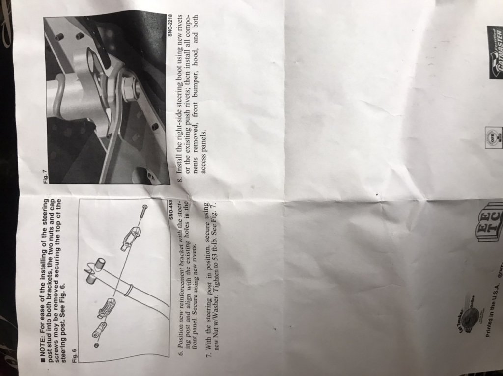

Still, waiting on the parts to ship, but i went ahead and got the airbox off, getting those screws off on the bottom wasn't so simple. I did get the airbox out. Now, do i need to pop the rivets off that are holding the goldish color piece?

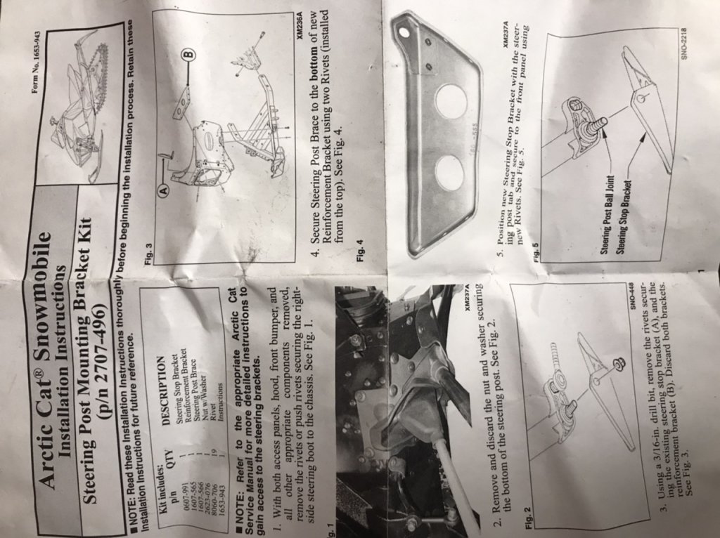

Disregard the part no on these instructions. It’s 2st kit but same process. Sorry I must have tossed instructions for the viper kit when I put it in. Basically same though.

Perfect, thank you, so its basically just setting in place and riviting it on.Disregard the part no on these instructions. It’s 2st kit but same process. Sorry I must have tossed instructions for the viper kit when I put it in. Basically same though.
View attachment 154855 View attachment 154856
Yes.

Does the new reinforced bracket take the place of bracket B on figure 3? because bracket b is broken. Stupid part still hasn't come in thoughYes.
Yes kit comes with that one.Does the new reinforced bracket take the place of bracket B on figure 3? because bracket b is broken. Stupid part still hasn't come in though
ArcticRider
- Nov 19, 2018
- 162
- 39
- 243
- Above the Arctic Circle, Alaska
- 2016 Yamaha Viper STX-DX 146
2021 Vk 540
Now it all makes sense, i just got it in the mail 10 minutes ago.Yes kit comes with that one.
