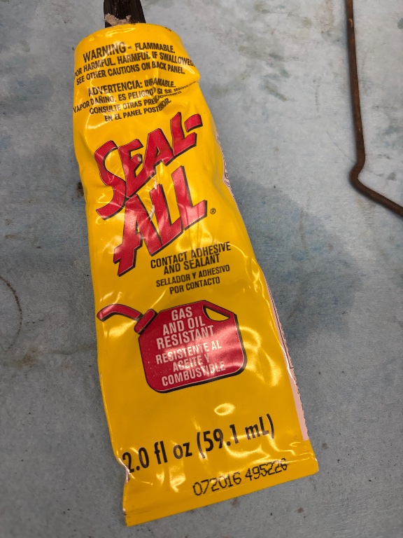

Trail tank update.
I finally got to go out for some trail miles today and filled my sled for the first time.
Issue 1. I put the fuel level sender in wrong. The float would not go all the way to the top. I need to turn the unit 90 degrees to fix the problem.
Issue 2. While fixing my mistake on the sending unit, I saw a small amount of fuel on top of the pump sending unit. I looked closer and could see fuel coming up through the screws that hold the sending unit in. With the trail tank, the screws go all the way through the tank shell and into the tank. I removed all the screws and sealed them with some fuel resistant sealer. I then jacked the front of the sled up for a bit to see if the fuel would come out. So far so good.
Just beware, when installing the tank sending unit, seal the screws holding it on.
