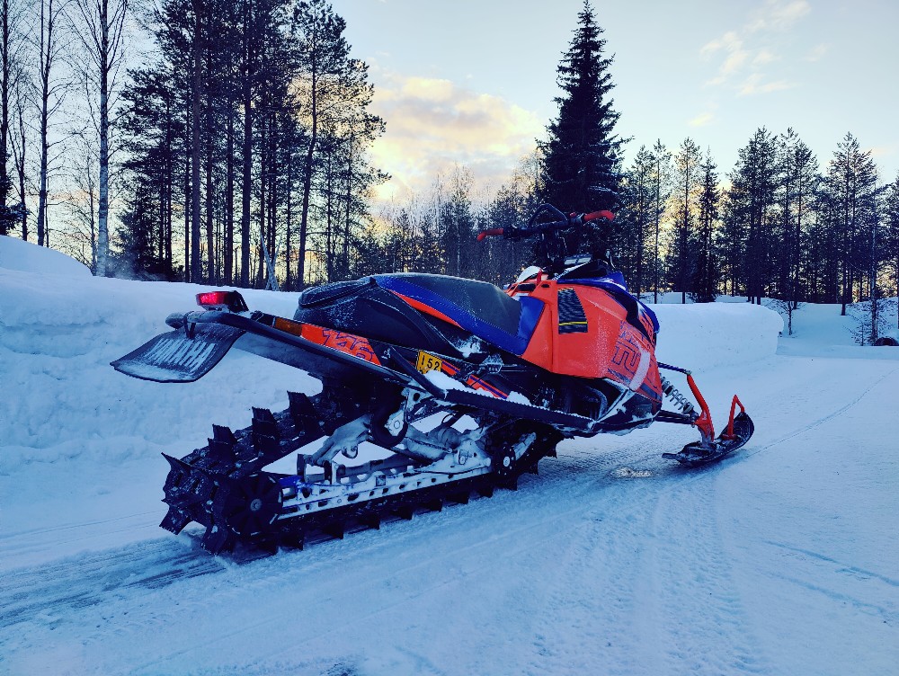

Challenger extreme 64 and original 9t 2,86 drivers it just have enough room to rotate freely

Clearance to hoses in front is 1,5cm. Rear tunnel, cooler hoses and bumper is cut 15cm shorter.
