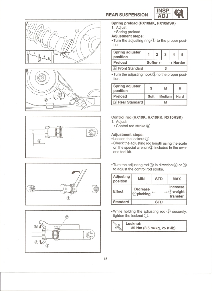

I've never adjusted a Control Rod. So looking at it I see its threaded. The knob with the notches should be turned to thread the knob in so only a few threads show?
- Jun 28, 2004
- 2,436
- 500
- 1,723
- Clinton, Wi.
Correct in principle. You should have a wrench in your tool kit that looks like a spring spanner tool. It'll have markings on it with a scale. 1 end reads Min, the other Max. There is a procedure in the manual that shows the proper use of this tool. Basically, release the locknut, back it off, and you place the end of the tool against the moveable portion. The scale gives you the range of motion for the control rod. I'll see if I can find a link if you don't have your manual. Found it. http://ty4stroke.com/download.php?id=48967

Viper_Dave said:Correct in principle. You should have a wrench in your tool kit that looks like a spring spanner tool. It'll have markings on it with a scale. 1 end reads Min, the other Max. There is a procedure in the manual that shows the proper use of this tool. Basically, release the locknut, back it off, and you place the end of the tool against the moveable portion. The scale gives you the range of motion for the control rod. I'll see if I can find a link if you don't have your manual. Found it. http://ty4stroke.com/download.php?id=48967
OK thanks got it. I haven't done it yet. I developed pheumonia and broncitus..but I'm getting better. Been working too hard. Bummed bad..missed som good riding here finally.
You said 2 lines? thats not much is it.
Thanks for the link Viper Dave, I may have to add a touch more ski pressure myself.
