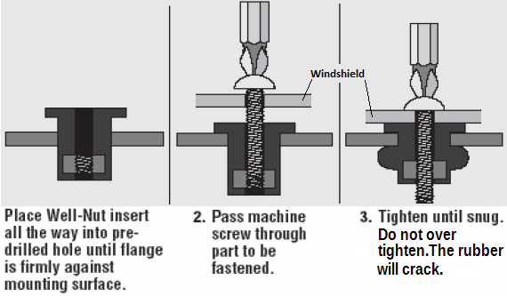

MAINEiak said:Installed mine 2 days ago. Used (4) 1/4"-20 x 3/4" well nuts and (4) 1/4"-20 x 1.25" stainless steel button head
(lower profile) cap screws & washers. Also used collar stops on drill bits to prevent drilling too deep.
All fasteners and stops came from local Lowe's store. The whole install went fast and smooth.
Just drill the rivets out with a 1/4" bit. Then drill final holes to 31/64" (just under 1/2")
and you will get a snug fit when the well nuts are inserted. For the 2 bolts on the "nose" section of skid plate, just
replace factory bolts with the 2 longer metric bolts that come with the install kit. The rest of the kit will not be used.
Tip: If you have difficulty inserting a well nut, thread a bolt into it, lightly tap it into place with a hammer, then remove bolt.
How "well nuts" work...
I just wanted to thank you for your post. this is exactly how I installed mine today with well nuts. That is the best way to do it. The only thing I had to do was drill out the rivets bigger than the drill bit you recommended. The well nuts I got from lowes were very thick. I took a grinder to the well nut and kinda tapered the edge of it to get it started then screwed the bolt in and tapped them into place. Very tight and snug fit. I messed up 1 of the well nuts working on it and had to go back to a local hardware store to get a replacement and they had the same 1/4 20 well nut but the rubber was much thinner than the well nuts I got at lowes. Therefore I now know why your 1/2 drill but worked and I had to use one a couple sizes bigger. Thanks again and thanks for the great post.
