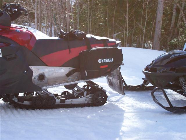

2 pics. One Yamaha with no ice scratchers and 1 with. Sorry pics are not that good. The Arctic Cat we were with had more snow in the skid than mine with the scratchers.
Although, I changed out the sliders on both sleds after this 1200 mile Gaspe trip and both were worn through to the rails. No wear on rails but they were through. Both at the bend in the rails. I put the marginal snowwheels on mine but it hasn't had to be tested this year...
Yeah, pretty much exactly what I noticed. There are options for fixing the problem but why the lack of snow in the track area? Definately something going on with them compared to other machines when it comes to the lack of snow being retained in the rear suspension.
I use Slide Kicks cable scratchers and they work very well. They throw lots of snow/ ice into my skid. I replaced my sliders at 2200 miles and they had lots of meat left -- I changed them too early.
Budweiser -- if your scratchers are truly down deep enough into the snow dragging, then they should be kicking up more snow then they are for you. Have they possibly worn down a bit and need replacing? Just a thought I had, because my skid gets caked with snow and i see yours looks dry. Weird.
