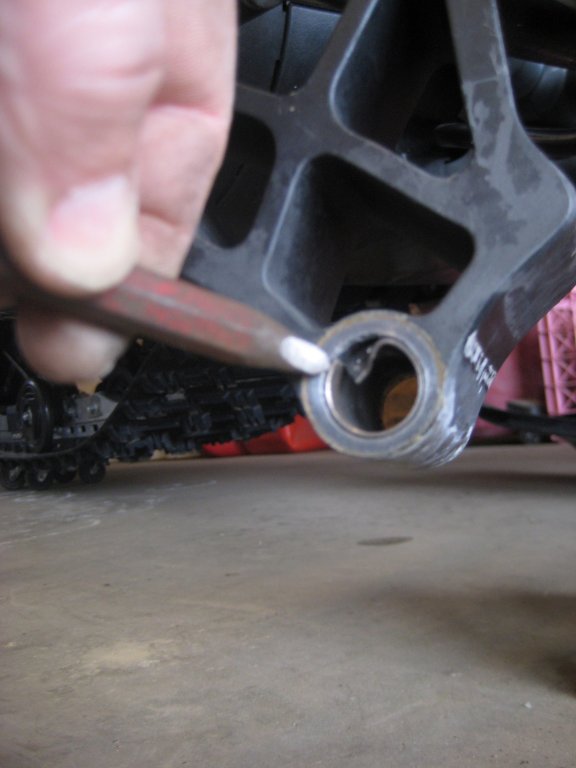

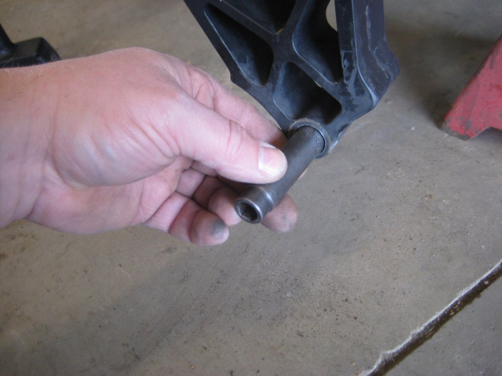

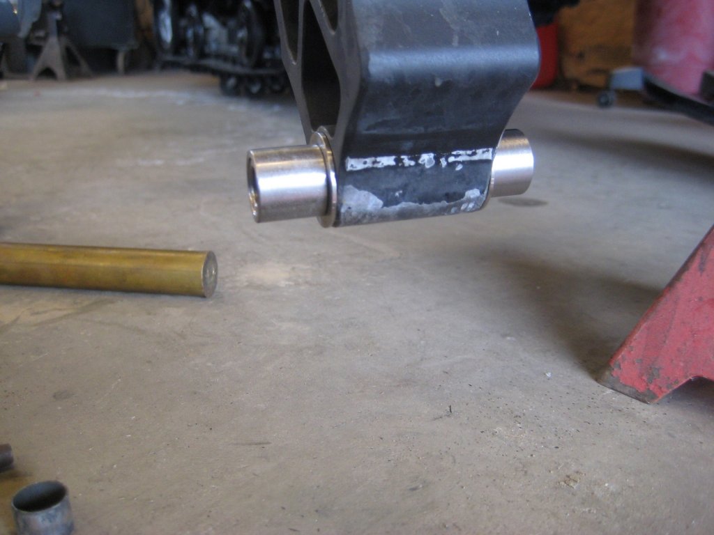

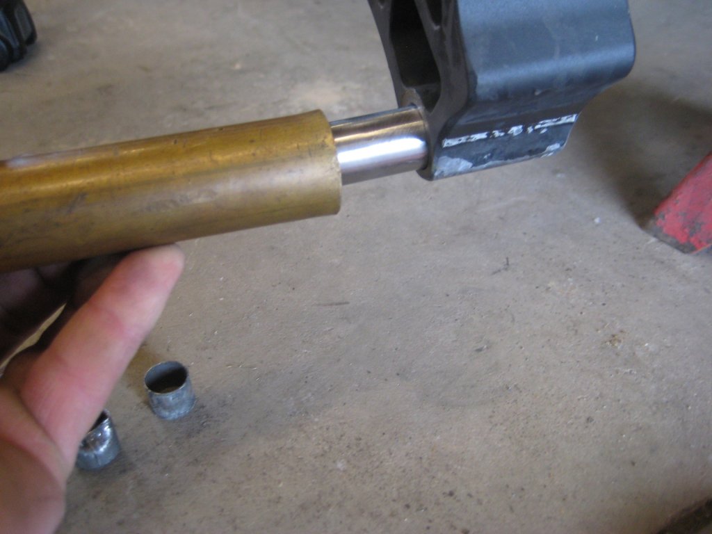

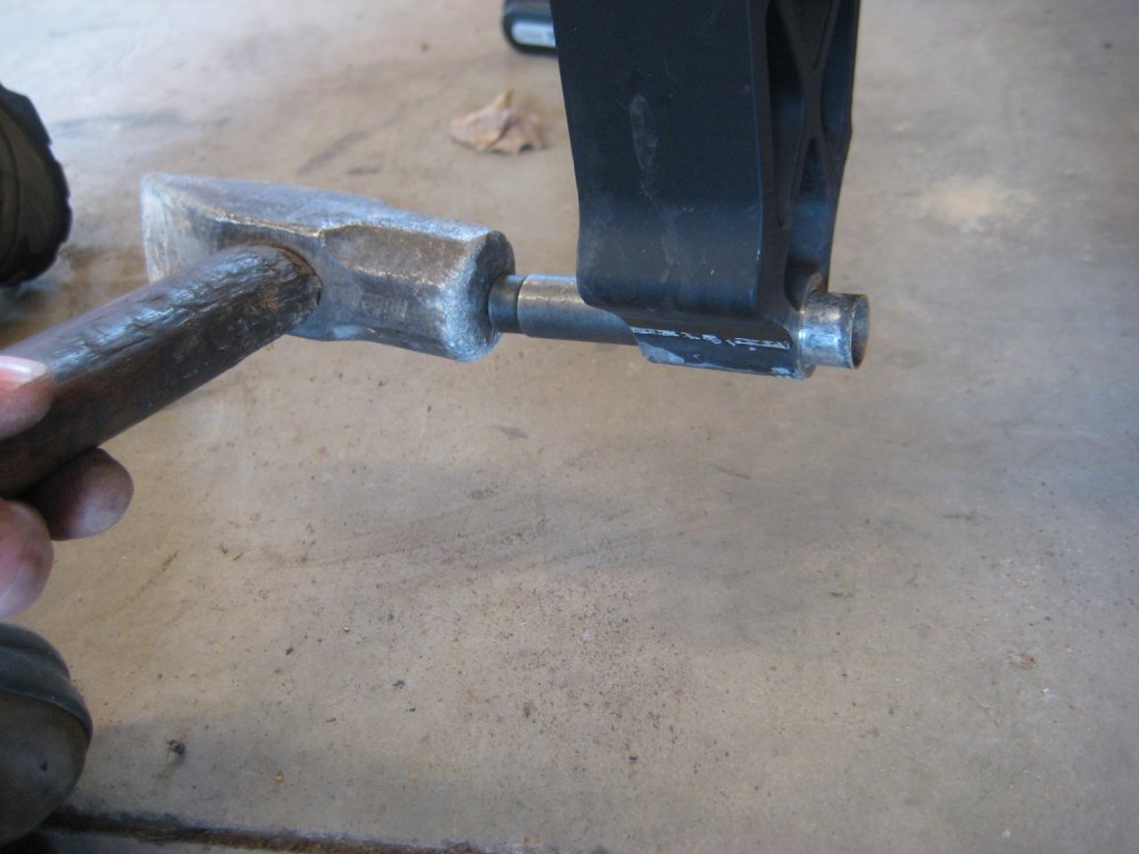

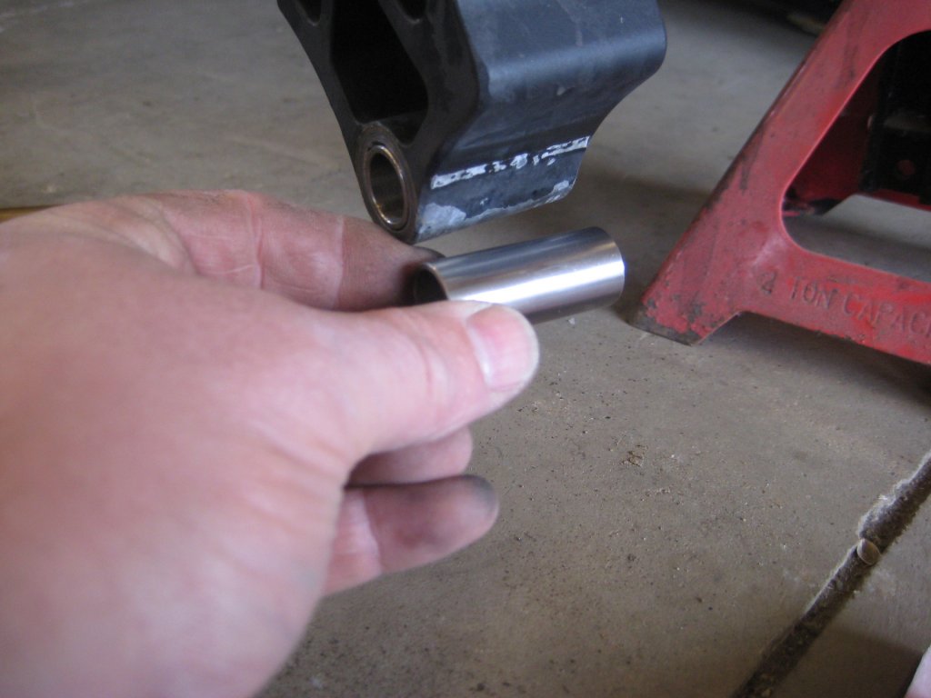

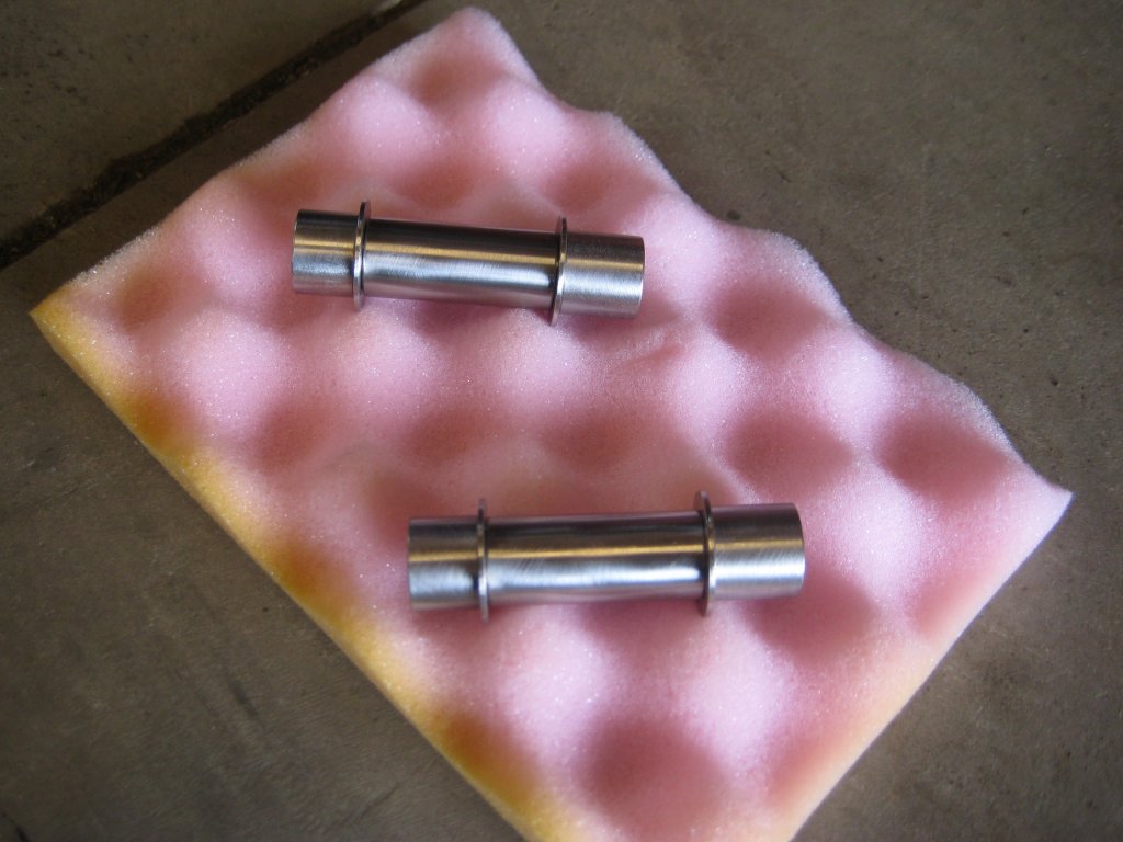

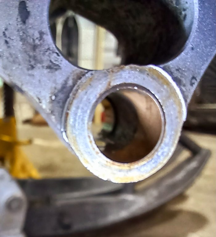

I order a set of premium bushings from UP bushman. The upgrade kit is all stainless steel with a full length single bushing that fits snugly in the spindle and should last much longer than other options. Here are some pictures of removing the OEM bushings and installing the kit.
Clean end of bi-metal bushing and locate slit:
Use a tapered punch to roll the bushing starting at the slit:
With the bushing rolled over use a socket or bushing driver to drive both bushing out at the same time:
Premium bushing kit:
Clean the spindle then drive/press the new stainless bushing in:
Grease bushing and anti-seize the spacers:
View attachment 135833[/QUO

That is great but how do you get the collars out to get at the old bushings?I order a set of premium bushings from UP bushman. The upgrade kit is all stainless steel with a full length single bushing that fits snugly in the spindle and should last much longer than other options. Here are some pictures of removing the OEM bushings and installing the kit.

Reviving this one! My '16 venture MP has a lot of play (especially the right ski). I'm putting on C&A Pro MTX skis, and want to replace the bushings as well. Are the stainless ones still available? Mine seem different then the ones in the original post (mine are two separate bushings). I haven't found them anywhere else online.
