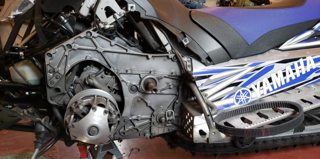

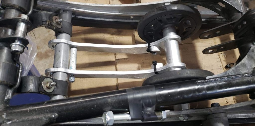

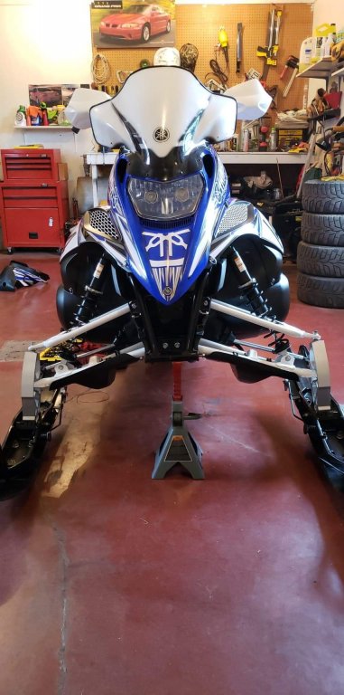

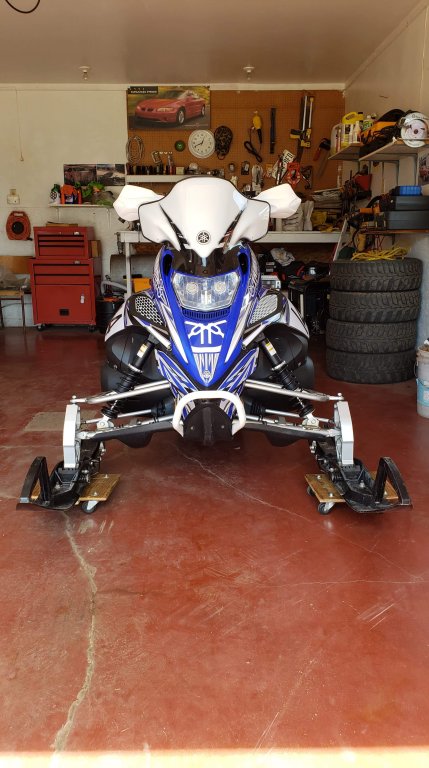

Got bored sitting around.
New olite bushings.
Taller windsheild painted white.
Star suspension kit.
Shocks also done by star.
All wheels cleaned and greased.
Front A Arms painted white.
Changed oil/gear oil.
Greased bearings.
New plugs.
Yamaheaters installed
New olite bushings.
Greased bearings.
New plugs.

How and what kind of paint do you guys use on your windshields??
rev them up
- Apr 3, 2006
- 185
- 129
- 953
- Prince Edward Island, Canada
- 2011 Nytro XTX, Hurricane Exhaust, K&N, Pcv, Autotune, Pod300, Star Suspension,
2018 Sidewinder, TD Max Spool 17, CAI, TD 3 Inch Stock Muffler Mod, 3Bar, BOV
I used plasti Dip...light coats... works great..second windsheild I have done. Spray the inside of the winsheild...that way the cover, three branches, etc does not tear it off. I have had no issues..also had my front bumper done..I just did my A Arms this spring see how they hold up next winter
RobX-1
- 2,586
- 1,752
- Coldwater, OH
x2 on the Plasti-Dip. The nice thing about it is that if you screw up, just let it dry and then peel/rub off and do over. I have done 4 now but on my first attempt, I tried to paint it to hastily and ended up having runs on the curve portion of the windshield. Having a white backdrop really brings out the colors on your windshield if it already has a design or decals like my 50th Anniv Apex windshield. Did the same with my 40th Anniv Apex and Nytro windshields. Another nice thing with Plasti-Dip is that it is flexible and does not harden like traditional paint.
