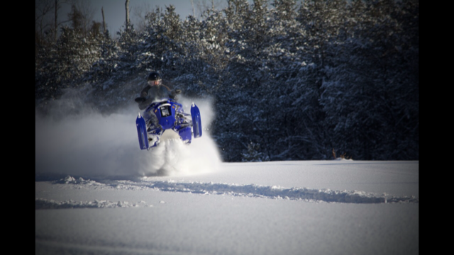

The 137 is a blast off trail with a Hurricane 1”75 ,remove the coupling block and add anti stab wheels to front of rails. 17 xtx anti stab will work. It is a hand full set up this way, acts like an old two stroke 500 dirt bike. Leave snow flap on, you’ll need it to keep sled from coming over onto the rider. Have 3 years on this set up and love it! Not a lot of trails where I ride but ride at least 1500 miles a year. When ditch banging the nose is way light with this set up so rider beware, keep speed below 60 mph when launching. It is easier to ride with coupling block in though. Believe what I say, no bs coming from me.
