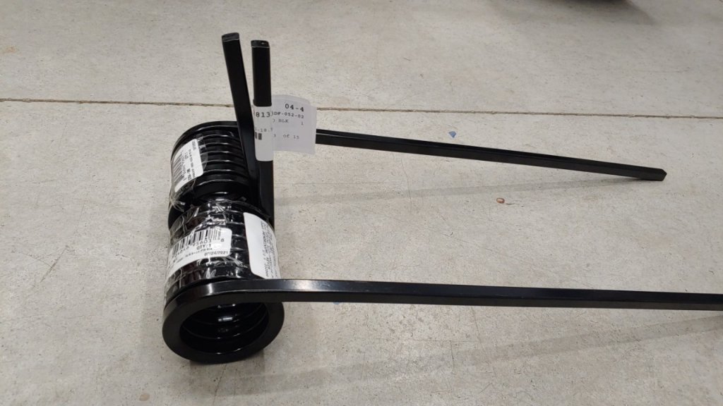

Does anyone have the spring part numbers for the srx

3074-380 & 3704-381, if you are referring to the rear torsion springs. I just ordered a pair for my 17 LTX. But... they are supposed to be 100-degree angle between the legs. The 3704-381 measured 101-degrees but I ordered in 2 of the the 3704-380 and they are both 108-degrees.Does anyone have the spring part numbers for the srx

Thank you
