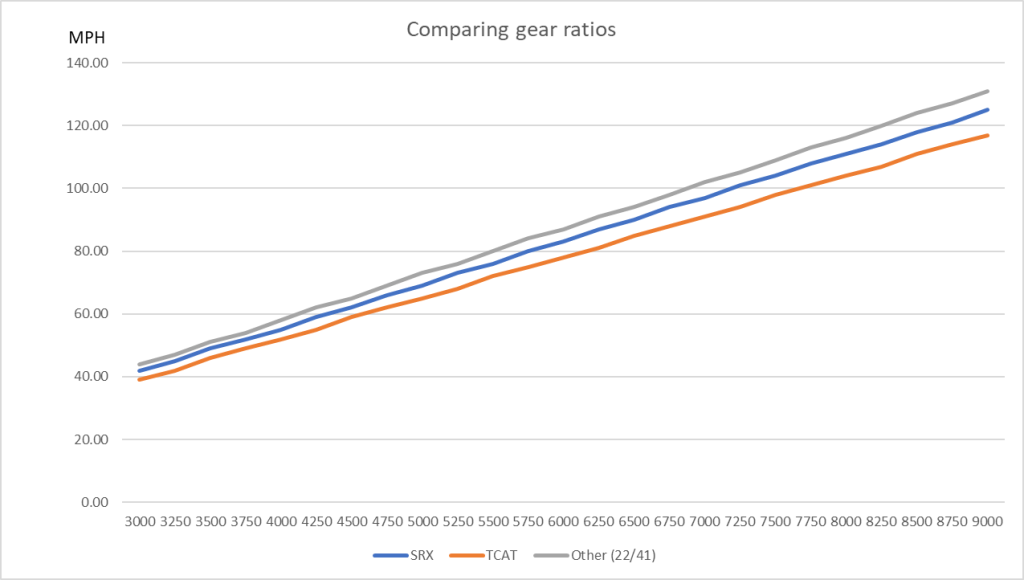

In 1000ft or so (with equal traction) the 24/50 is a good choice for my bone stock 2022 Tcat. I like 21/38 on my 2014 ZR9 with a 300hp tune. Not sure what I will run when I boost the Tcat.The SRX (21/41) is about 6-7 MPH faster than the T-Cat (24/50) on paper which is likely the real world as all other factors are equal.
Taking gears only into account.
Gear Ratio Calc Top Bottom Calculated Ratio SRX Stock 21 41 0.51 1.95238095TCAT 24 50 0.48 2.08333333Choice 1 22 41 0.54 1.86363636Find other gear ratios 25 46 0.54 1.84
Top Speed Calc SRX Stock 123.46TCAT 115.70Choice 1 129.3422/41
